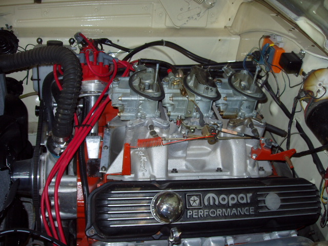

The torsion bars for a poly motor are good bars, That poly motor is 70 or so more pounds than a 318. I have a 440 in my 66' coronet with the 318 poly bars, and I found no need to change them. if it had been a 67', then I would have upgraded.

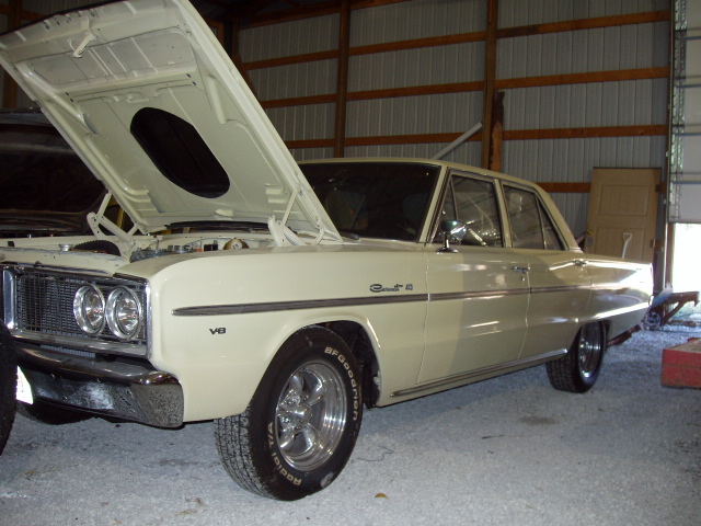

The question was , will the older bars work? Yes they will, as long as they haven't been damaged by not keeping the correct height, or driving the car with worn out suspension. The 66 bars for the 318 are as strong as the bars used in a 383 engine. If you are on a budget, you will be fine. I actually Installed a K member and sway bar setup from a 70' Roadrunner in mine, but used the original bars because they were the same Diameter as the Roadrunner bars, but had less mileage on them. The car handles very well, and I like the 70' swaybar location better than the 66-69 style.
I like those brakes, just didn't have any, so I Installed the Brake setup(disc) I acquired at PST. They work great..
