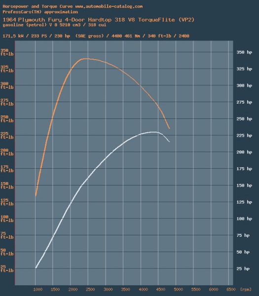

I think the 3.23 is worth a try. But if the RPM is just to low, I would look for a set of 3.55s. My poly engine is stock . The car is just going to be a fun driver.
With an auto it might be ok, with a stick I'd say too low. With a stock cam it might be ok that low, but 50yr old cam and open chamber heads aren't very efficient at low rpm
Plenty of torque from a stock poly at low RPM.
