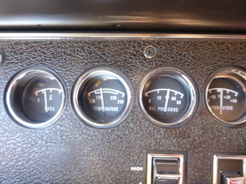

Is your temperature gauge correct?
My experience is it should run close to the thermostat rated temperature.
180 F thermostat is correct. If 210 F is too hot for your liking then find out why and correct it. I like being around 180-200 F.
like Tony Tee said it should run close to the thermostat rated temperature, just above it. If you are driving hard the temp gauge should increase a few degrees higher then normal. Of course this is with a cooling system that works correctly!!!

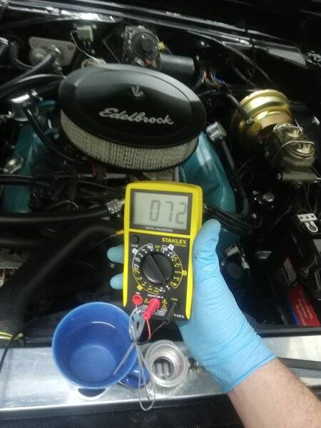

383HP, stock 2 core OE x 22" rad, stock 7 blade fixed fan (no shroud), stock pump (and we're talking a 52 year old one!).. running it hard yesterday on a 90F/99F humandex day highway and town with a 190 thermostat and my gauge is verified correct with sender in boiling water. As for that high flow pump, keep in mind that heat dissipation is a time game and you could be putting fluid through the radiator too quickly. Also you didn't say what you're running for a fan blade. Please don't say a speed shop flex fan.

i verified the sender at two spots
Water 72 deg C / 161 F, my gauge was slightly below 170
Water deg 57 / 134 F, my gauge was a bit above 120

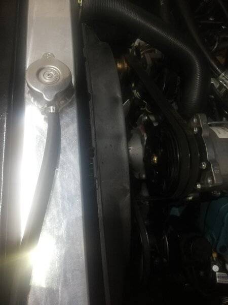

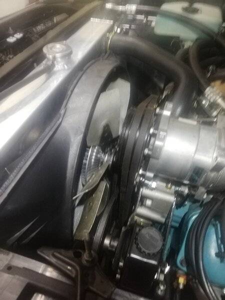

Running a Hayden HD fan clutch and the fan that came with the car - no cluevwhat it is (see pic) also have a derale 6 blade fan here but the noice level was just too much
Shroud (but with a small gap) is also installed

I used to believe high flow was the cure until I got into bring my RT all numbers matching front to back. They actually slow the water down on a/c cars, the pump has less impeller blades. Make sure you fan clutch is engaging at the proper temp, adjust if needed. Run a quality large opening thermostat , proper mix in a clean system with good timing and not too lean and lid should be good. I recommend the proper fan blade too of course ... Here is my curve ball, if you have the oem radiator and it’s known to be good,swap it as brass and copper is better than aluminum just not lighter per a very reputable mopar radiator shop up north.
