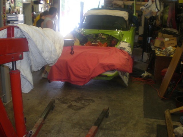

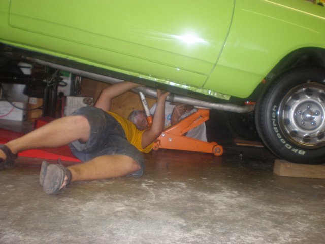

i have found that raising the rear end of the car with a floor jack allow for a more stable engine/trans and engine hoist angle and less chance of hitting your radiator core support as the engine will clear quicker

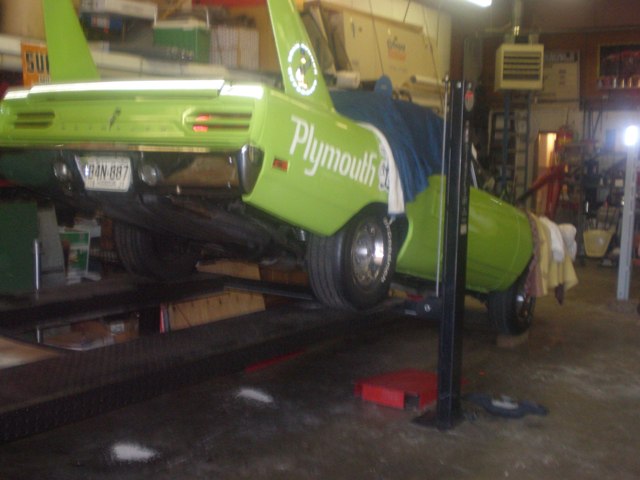

or even put the rear wheels on a 4 post lift , makes for an easy slide in :headbang:

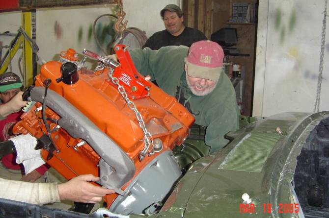

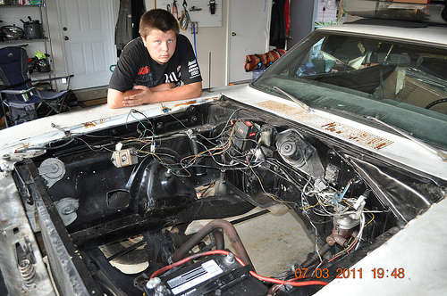

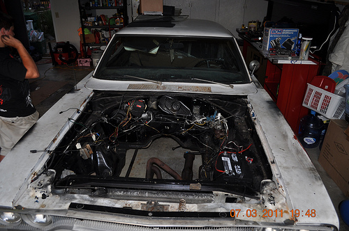

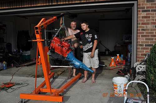

Pulling motor and trans together 70rr
Just a few shots of my son and i doing it all at once.

charlie, do not know if you knew this or not, but your valve covers are on the wrong sides :D, but if you do realize and dont care, do not pay attention to this message :headbang:
That looks like a 68-69 left side valve cover to me... why do you think it's wrong??
i like that adjustable carb plate attach. where to get one? tnx
Yeah it's a beauty!! Got it several years ago. Pulled/installed a bunch of engines with it. It uses a ratchet to adjust angle- very percise and easy. Only problem is if you let it out to friends to use getting it back:laughing1:
If you're really interested I can get where I bought it from. It was a small firm who manufactures them. It was about $60.00 8-10 years ago, but IMO worth every penny!
I was not sure what he meant by wrong side covers either?
I am the dummy :oops:, please do not pay any attention to the guy that is stuck in 71/74 lala land... now you can return to your regular programming
