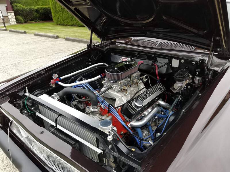

Week ago l was putting my car to bed for the winter. Changed the oil and it comes out looking like l haven't changed it in years and there is some crud on the magnetic drain plug. I spread it on a kleenex and l can see what looks like little silver beads. I took the filter to a local garage to see if they had a filter cutter but the machanic was away. I'm not going to do anything now because l have a new project, 67 vw baja underway that's suckling all my money away. This next spring I'll get the engine pulled and torn down. Depending on how it looks will tell what's needed, but I'm hoping nothing to major. The car was running great, 50 psi cold idle 32 hot. Lucus 20/50 Hotrod and Classic oil. Maybe l caught it in time and no major damage other than rings and bearing. However it goes, I'm going to get a hydraulic roller cam. Its a 72 block that l got out of a car that someone had replaced. I can't tell you much about it other than it has a mild lumpy cam, 906 heads and burns regular gas, low compression, 727, with 4:10 Suregrip. It's just a Sunny Day Cruiser that gets the carbon blown out regularly. Can you guys recommend a cam ?
