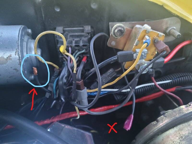

When I turn the key to the 'ON' position and hold it in a "sweet spot" she stays running. When I let go of the key she turns off. I thought it may have been a bad ignition switch so I replaced it. Same issue. I checked the bulkhead connector and noticed a loose wire. Not it. There is a wire that has a 'fresh' end revealed that I honestly do not recall seeing in such a state before. I do not want to just go stuffing it into the connector and risk messing something else up. The wiring diagram is quite busy for me. Attaching a photo below.

Do you have a ballast resistor on your firewall, if so it sounds like it’s bad. The ballast resistor changes the voltage for starting and running which is why it will run with the key in the start position and not the run position. I would also put that wire back together and maybe see if you can clean up your wiring.

I want to disconnect the battery and re-connect the wire on the left. My concern is blowing something and push me back to square one. I will need to study the bulkhead connector diagram to see what goes where to see if that leads me to a "Well that isn't presently working. So..." moment. Who knows, that may resolve my left turn signal issue (secondary concern).
The wire on the right marked with the 'X' has been that way since I have own the car. Not sure of its purpose.

If if were me I would want to know where that wire goes to before connecting it back up, it may have been disconnected under the dash.
Roger that. I will check the wiring diagram. There are a couple of hanging wires that I need to resolve.

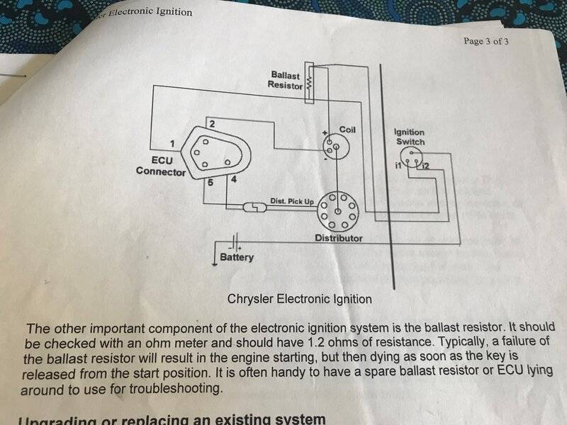

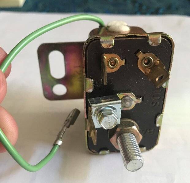

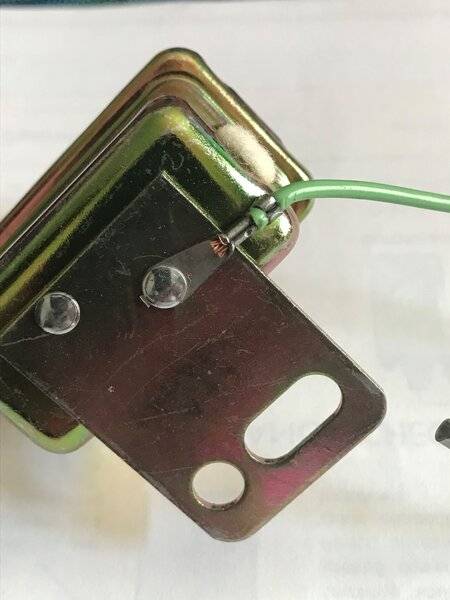

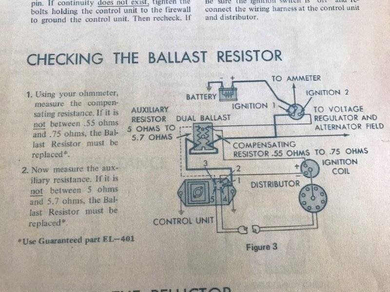

Unsure if you have the Mopar electronic ignition setup, but if you do, here's some reference material addressing the ballast resistor and the symptoms you are dealing with. Also, that loose wire, with the X, in your photograph near the starter relay, wonder if it is this extra wire that the MP starter relay comes with (which can just be cut off, looks to be an additional grounding wire).
View attachment 1132013 View attachment 1132014 View attachment 1132015 View attachment 1132016 View attachment 1132017
Yeah, I am seeing that it is a collectively agreement from all on this thread to have backups to the backups when it comes to parts prone to failure.
I do not have the electronic setup. However, I will take a line from the provided info, "Defective components cannot be repaired, but must be replaced." I am going to update any and every firewall component that I can, and have extra on deck for when I decide to journey 50+ miles to car shows, meet-ups, etc.
