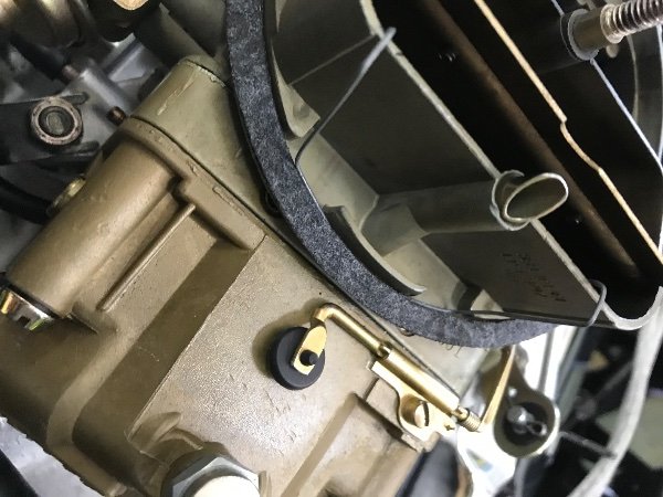

Just a picture for reference

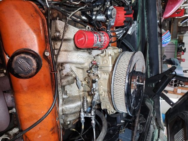

Not the answer to your question, but your air filter setup is quite undersized. Like trying to breathe through a straw while you're running.

Need to test either without the air filter or the filter spaced higher away from the fuel bowl vents. If the air filter lid is too close the the bowl vents it can mess up the carb metering.
