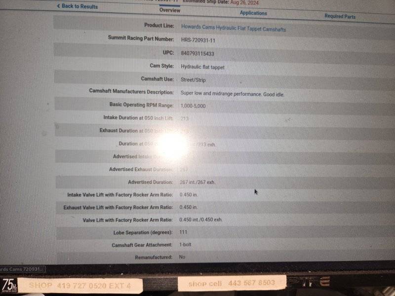

Cam specs

My $0.02... That's a really, really mild/small cam (213 @50) with very little overlap (LSA 111*), so you're probably pulling a lot of vac, especially at cruse. Depending on how you've set your idle circuit, that can be leaning you out. Check out @Geoff 2 post #2. I would also backup @Geoff 2 in post #18... you have way too little initial timing... I'd set at 22-25. As far as all in... you haven't (or I missed it) said the RPM at cruise. Based on how your describing, my gut says at 60mph you're around 1800-2000? IF so, I very much doubt your timing has come all the way in from 6* to 34*... so your base is 6* and 2000 at cruse, assume 25*? At that point your vac is high and you're basically pushing a portion of the combustion into the header, which will overheat and can cause lean read condition. Moreover, the slightest exhaust leak will let O2 in and cause popping as RPM increases.
