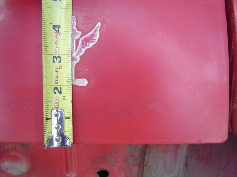

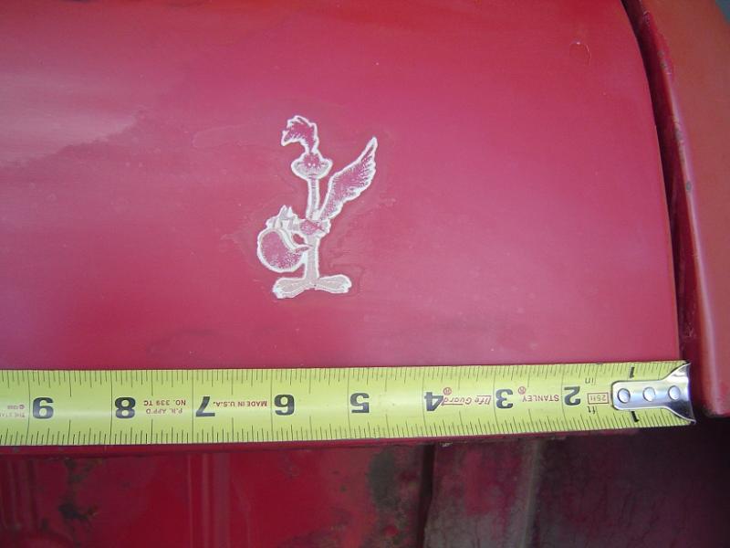

could somebody tell me the exact placement measurement for the bird sticker on the rear deck lid on the right hand side? Thanks, want to make sure it goes on exactly the same place as done from the factory..
sorry, goes on a 73 roadrunner
There were some subtle variations on placement, but I took measurements and pictures of mine before the restoration if you would like to use this as a reference.
Its 2 inches up to the center legs of the sticker and 5.5 inches from the edge of the trunk.
Here are the pictures before.

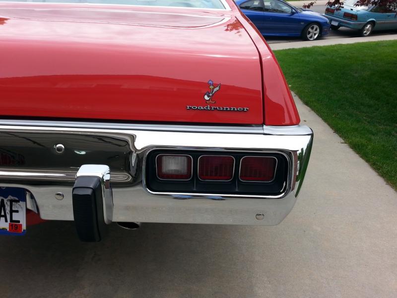

Here is what it looked like after the restoration
That's awesome, thanks. Let me ask you, did all roadrunners come with the roadrunner name plate under the bird? thanks again

Yes, all 73/74 roadrunners had the name plate located here under the standing bird. Also, its cut in the stripes on the sail panel, under the running bird. The front end emblem is standing bird in circle with Plymouth road runner on the circle.
can you give me the measurement from the lip of the trunk up to the bottom of the letters in road runner? Thanks, steve
