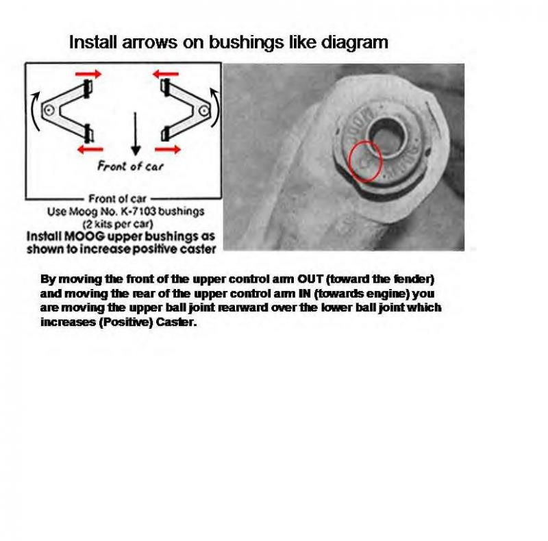

moog makes an off set upper control arm bushing to get more positive caster. there was a good post on this on the fabo section.
pic of moog bushing
hope this helps

Thanks, that would help some allright. Not sure if it would be enough though.
