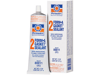

Here is what an old fart like me has been useing for many years, before silicone was ever invented, before any of these ten letter, four syllable worded compounds were even developed, and it has always worked. If the threads are a little wet, it sticks and seals. If it's in contact with coolant or oil, it's not going to deteriorate. When it comes time to disassemble it's still soft. It's older than me and you can buy it anywhere.
