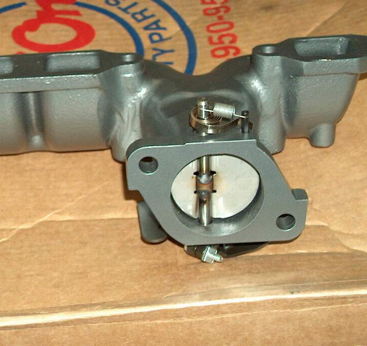

I want to take out the heat riser assy. out of my RH exhaust manifold (68 GTX).
is there some sort of trick to get it out?
i could cut the butterfly off of the rod, but then how do i get the rod out of there without messin up the manifold? looks like the rod is pressed in.
the riser in the intake is already blocked off, so im just trying to clean things up a little bit...and i think there's an exhaust leak coming from there too...

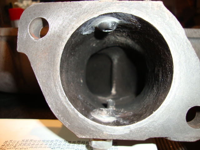

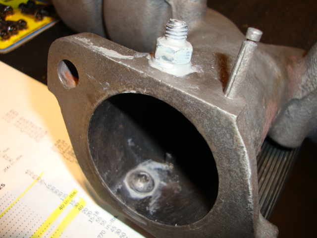

so got her done today...cut the butterfly out, used hardened bolts, nuts and lock washers and then slathered that muffler putty on it...still have to clean up the slather a little bit, but i think it turned out pretty decent. lets see how long it lasts lol.

I would have looked at just removing the butterfly and keeping the shaft in place to plug the holes, but this works too.
For the manifold to head you will need a gasket that has the perforated steel on one side, and that's the side that goes to the manifold. The flange will need a gasket too. Only exception is if you had the manifold surfaced.
I did the same as you except used a couple of socket head cap screws to plug the holes. This made a nice clean finished look.
Nice fix I need to do the same on mine, was going to use the high temp steel epoxy and just grind it smooth on the outside bu the bolt thing looks more permanent nice work.

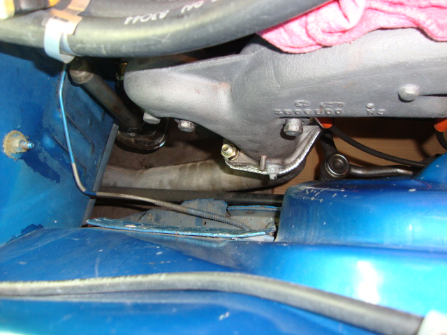

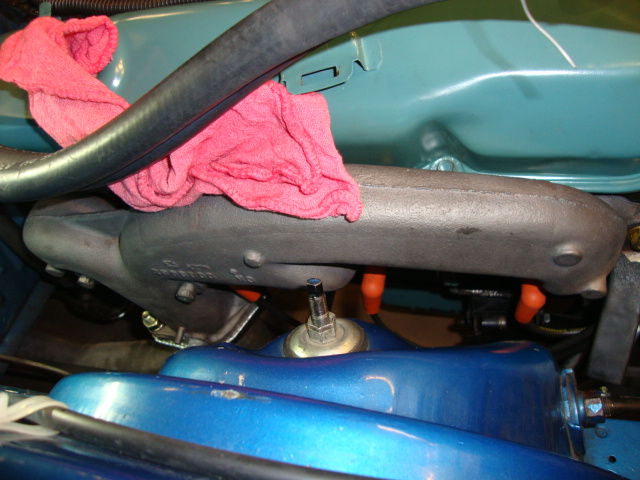

so now im putting it all back together, and the exhaust pipe+manifold is like a half inch off towards the front!!!
WTF!! did it just move on it's own??? i dont remember it being in a bind when i took it off!!
i loosed the pipe clamp that holds it to the h-part of the exhaust, sprayed a little pb blaster on it, and banged the hell out of it to see if it would move back enough to put the manifold on..no dice.
i have the manifold attached to the pipe right now...and i dont want to force it and mess up the manifold studs.
what do to???
thanks for any thoughts guys!!!

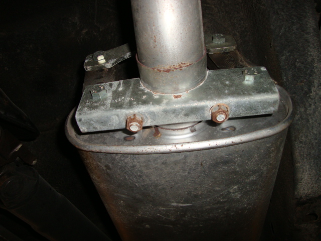

a little update...
so after calling a good friend of mine (chevy guy, but a great guy, nonetheless...lol) and takin a good look at it :icon_weed:
we surmised to loosen the band clamps (the two nuts facing down) that hold the back part of the muffler...and proceeded to do a whole helluva lot of wrastilin' and swearin' at the pipe, using a pry bar and center-point chisel to locate the holes from the manifold to the flange, and there it went!!! just like when she... :sex: well, nevermind...:eusa_whistle: (mind you, a flange gasket was used!!!:rolling:)

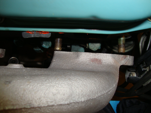

i do have a question for y'all; do the 2 sleeve bolts look right to you???
the forward-most one looks like it's sticking out too far. IIRC they are the same length?? i tightened them down as close to 30ft/lbs as i could.
any comments are very welcome!!!
