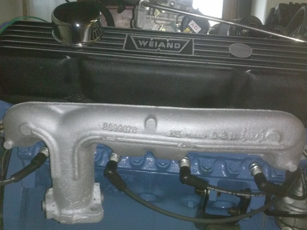

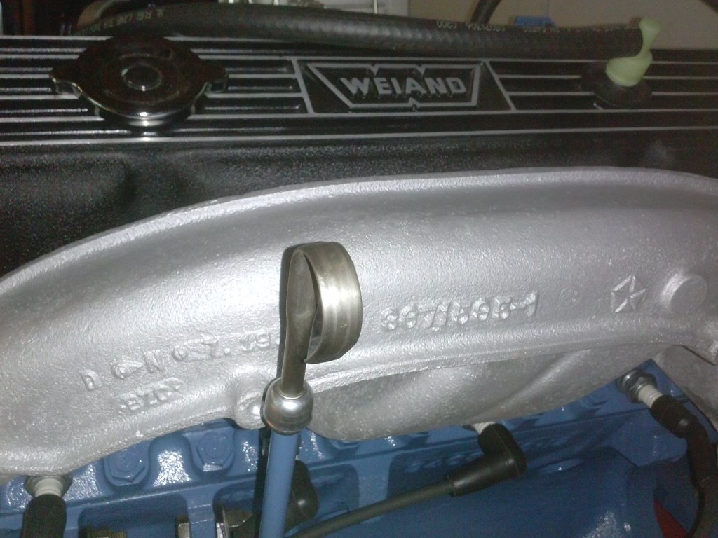

Why would a pair of 72 exhaust manifolds from a charger have one side HP and the other side a non-hp log type.
the drivers side casting number is 3671595 and the pass side is 2899876. which show as both being for a 72 B-body.
would the factory put one HP manifold with a non-hp manifold. both appear original to the car.
The only answer I can guess is that someone replaced one, maybe due to a crack...
I think it would have been impossible for the factory to have installed the full exhaust system that way, from the factory.
I have owned 2 72 SEs (400 2BBL W-AC) built this way. sucks because the outlets are different size.
