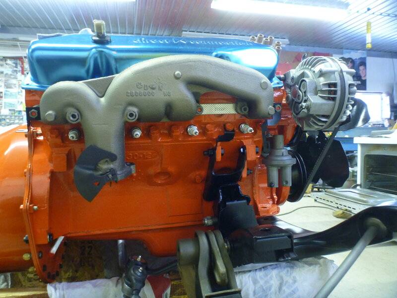

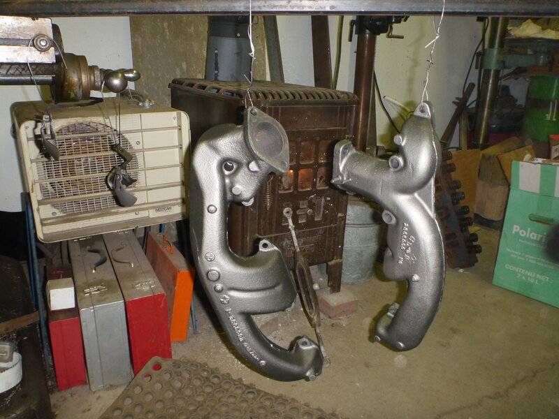

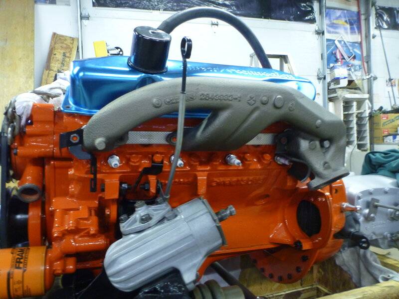

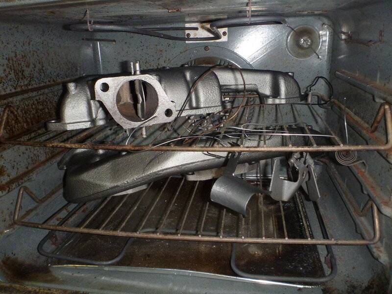

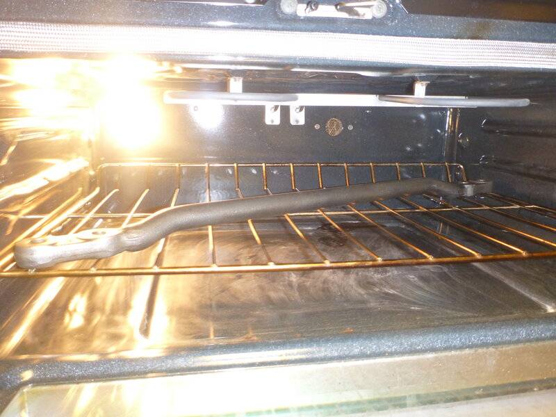

Don't forget to bake... still look great after 1000+ miles..
I used VHT manifold paint in "Cast Iron".

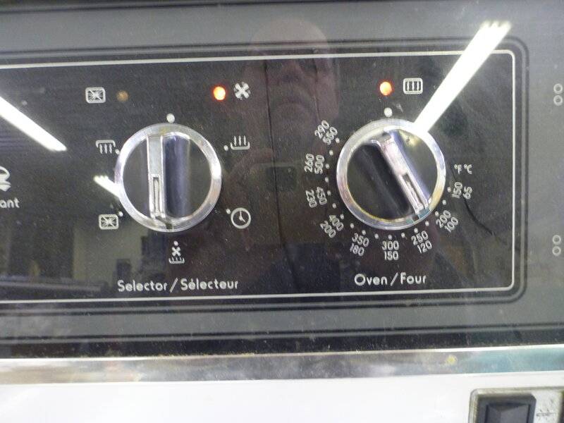

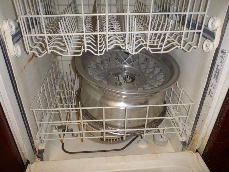

LOL.. that stove is in the shop, just a spare for such things! This one was in the house, she arrived home JUST as it came up to temperature.... and then there's the dishwasher...
My wife calls it "cooking car parts"
