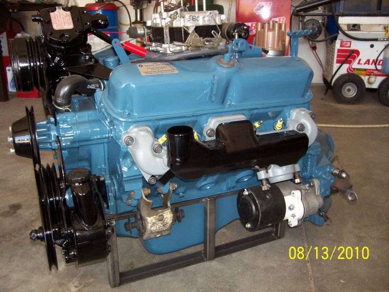

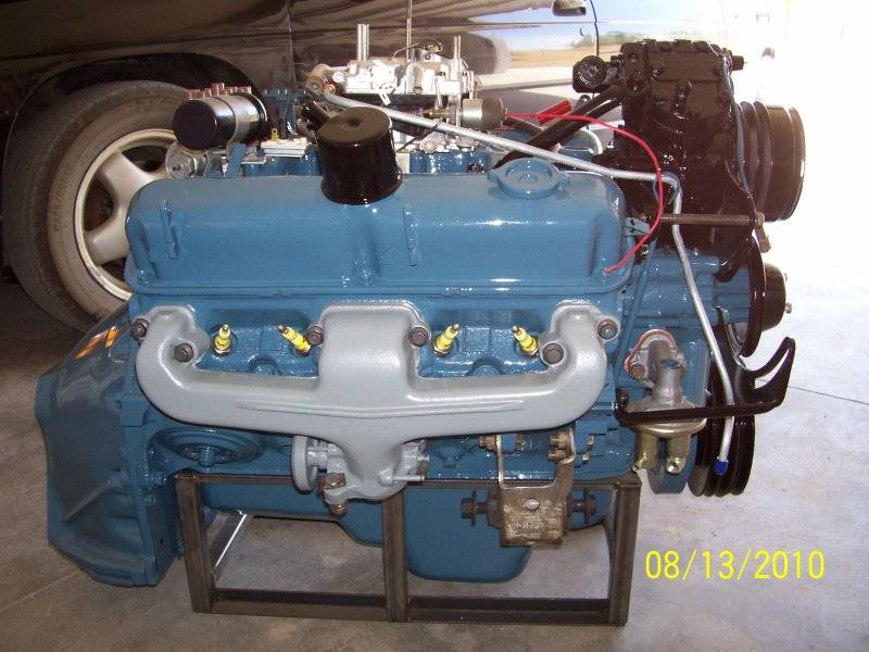

2013 not the best photo (blur), they were painted 1st in 2006-ish
2016 sorry not any great photos of them, you can see them flaking even then

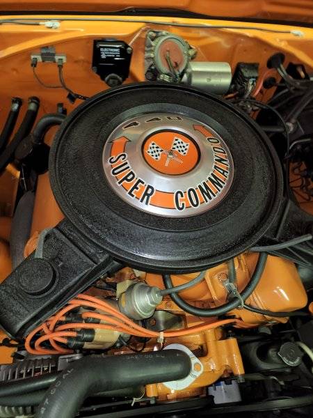

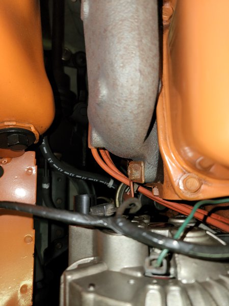

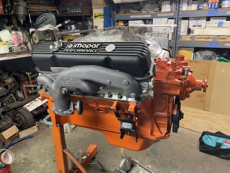

I use POR15 cast blast. That's what it was called 20 years ago. I believe it's high temperature cast coating today. The manifolds on my Superbird have been coated for 23 years and the rebuilt engine was first started 21 years ago. I let the engine heat and cure them. To this day there is no flaking, rust or issues.

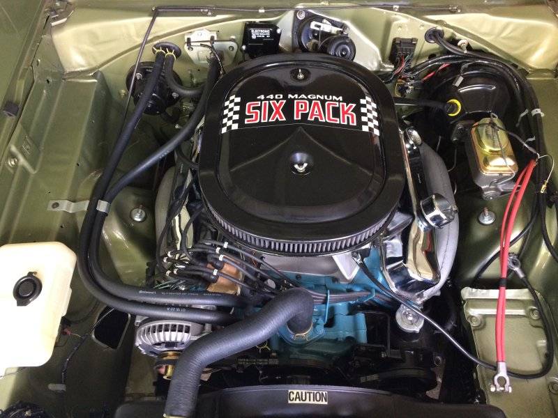

I had mine done by jet hot coating about 15 years ago. The color is a little lighter than cast but that is all they had back then.
This is what they looked like then.
This is a recent picture from about 6 months ago, I had to change the A/C front seal. They are holding up very well, no peeling or chipping. Looks a little darker in the picture but I haven't noticed it under hood.
