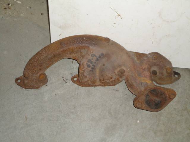

If you are changing exhaust, I recommend buying some 68-69 383 HP manifolds, and then new exhaust. Accurate exhaust produces high quality factory systems, I have bought three sets from them myself.
this is a c body version, but it gives you a good Idea what to look for.
