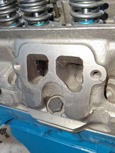

I have always run my stock manifolds with no gasket. When I bought my latest project I didn't hear any exhaust leaks but now that I am reassembling the engine, after getting the heads back from the machine shop, it seems a but of rust has eaten away the surface between the center ports. I believe I already know the answer but would you recommend using exhaust gaskets to be sure this seals. The manifold surface is pristine.

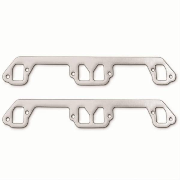

I did and I would myself. I cut the extra gasket material away and only used the area for the ports on the gasket
Remflex cannot be cut, bent, or trimmed. Great product.
Hmm, as per MWbirdLOVER70 's comment I was hoping if I needed a gasket to use one that I could cut the extra gasket material away and only used the area for the ports on the gasket. That way the gasket wouldn't be so obvious on a stock build.

Exhaust, slight pitting of the head should show in the picture.
Manifold to head, that little bit of pitting... No gasket....

Shouldn’t need with remflex gaskets.
Feel free to reach out to the manufacturer.

It is absolutely true that gaskets are not required when the surfaces are of the same material , surfaces are true, and the temperatures are the same. Most manufacturers have not used exhaust gasket for many years because of the condition of the mating surfaces when new.
Gaskets are used to compensate for different materials being connected together that have different expansion and contraction rates. Like iron block, aluminum head etc..
Looks like the builder would have noticed the rough surface and would have just had the machine shop run a pass or 2 over the exhaust ports to true the surface. Too late after they are installed though. Just use a quality gasket and new fasteners.
