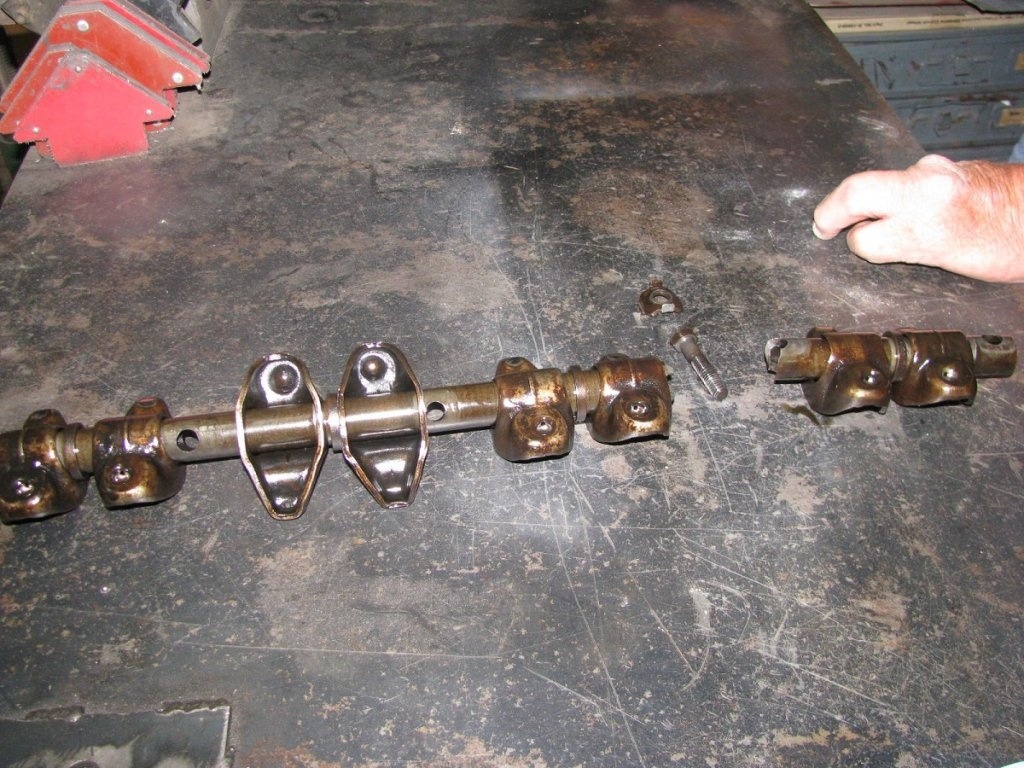

Another adventure---Went to a car show about 60 miles away this past Saturday. Brutus has been runnig GREAT ! I noticed a faint "clicking" when I arrived. When I left, the clicking progressivley got worse along with a "miss" Then it got much worse noise. I had good oil pressure--I bet a cam lobe wipeing out. Stopped to get a fresh ZDDP additive. Started up,---no oil pressure. Called a friend to come get me with his trailer. Pulled a valve cover off, and here is what we found.........................................MO
