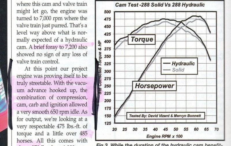

Top of post #12.I didn't read anywhere that this is a drag race only car. This is what MVA can do.....
