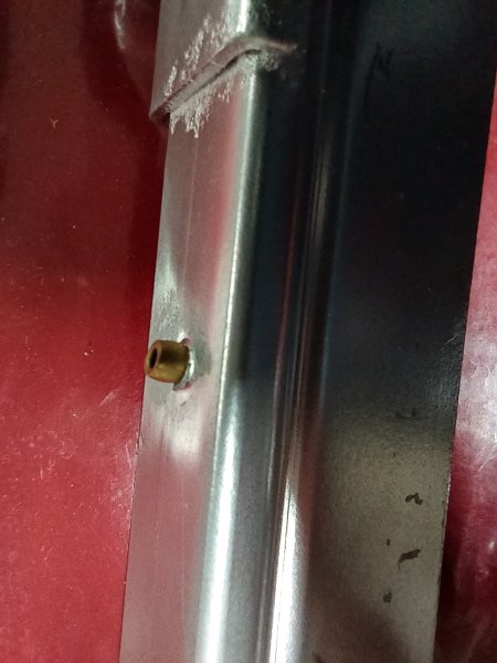

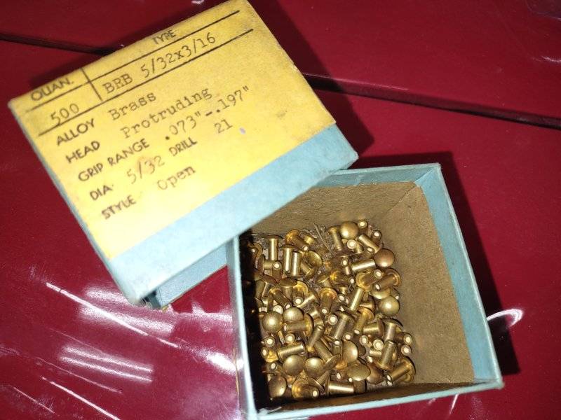

Used some old industrial exploding rivets to install flocked rubber to window run channel. Worked great, you use soldering iron to set them off, sounded like a 22 short. Rescued these from my Dad's estate years ago. They are probably 30 years old.

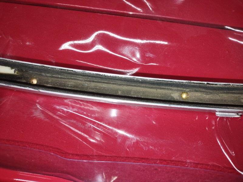

I hope the heads pulled down into the flocking so they're below the surface.
The heads pulled down pretty good. They are just barely below the flocking. Should be fine.
I have 3 boxes of three different sizes, I'm sure my Dad got these out of the Chrysler Twinsburg stamping plant.
there's an explosive charge at the tip that flares the end? Don't suppose you'd set one off for us.

I'm imagining the cylinder expands to fit the hole and the end splits like a plugged rifle barrel.

Actually pretty fool proof. Great for an area you can't get behind to use normal rivet. Had them, tried them, worked fine. Probably never have another use for them.
