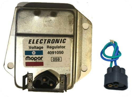

Photo please. There are no 2 pin modules. 4 and 5 only. Electronic voltage regulator may be?
This one?
Yep that’s the style I have it has 2 pins and a 2 pin plug. Like in the photo. Mine doesn’t have a sticker just “made in USA”. I still have points and a condenser.
Hence why I found a pic with a decal indentifying it as a Voltage regulator LOL.
Search for a Mopar electronic voltage regulator and will find it everywhere
To clarify it's a voltage regulator and it controls the alternator charging.
Not related to the ignition circuit.

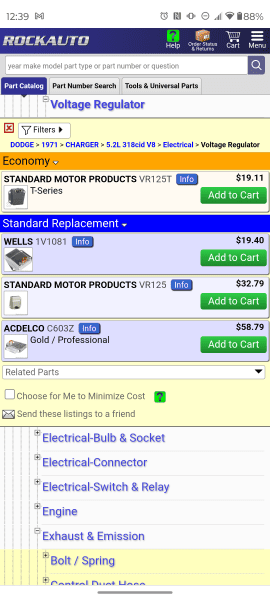

Readily available the standard VR125 should work fine.
Readily available the standard VR125 should work fine.View attachment 1895810
That's a electronic voltage regulator not a module (Ignition module)
