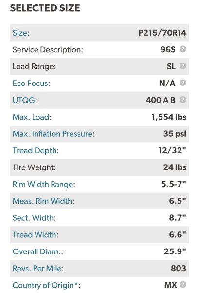

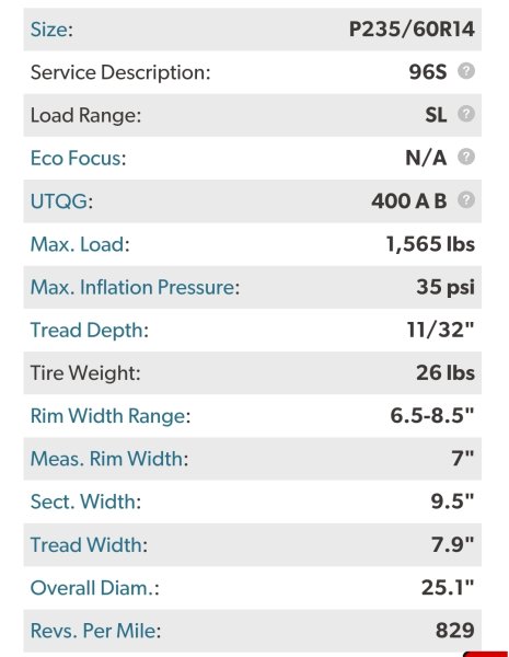

Tire rack had the tread width and height listed for those 2 bfg sizes.
Thank you for that info, just what I was looking for. Once again you guys cane through!
