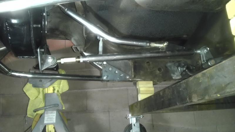

project stunt double general lee...im buildin this charger not for show but for some thrashin, driftin and not afraid to add new dents. plus good advertising for our restoration shop. too many cars at the shop, garage is full aswell, so brought this one home to build after hours in the rv parking. once i get the challenger done i will bring it to the shop. i decided to use this rusted, bent and beat charger to paint up like a fadded out general lee that was left to die. but first gotta add my new suspension setup on it. after spot welding the brackets to the chassis the rear k member will bolt in strenthening the whole rear clip and will have subframe connectors. now the b body is under and over slung like our racecars. the charger will have all urethane bushings (heim joints beat up the chassis too much for street use) and of course coilovers, watts link, 2 link trailing arms and a torque arm connecting to the front of the rear frame rail wich is plated and will add about 15% more forward bite. i wanted this so if i produced them for others anyone would be able to install it with minimal welding. been building race cars for awhile and all those 4 link kits ive seen for b bodies....not fond of. anyway just thought ide share what im building. soon as all the jigs are done im building front tubular k frames, suspension exc...rear suspension and more.
not trying to advertise....just sharing. no where finished yet

Very interesting. Keep us up the date. I never have been a fan of the 4-link set up for the street or corning. Its a straight line setup as far as I'm concerned.
Rear k frame, huh? Interesting stuff, I can see how that would form up the whole rear clip. Got any more photos? Looks cool.
yea ill post more pics as i go, takes 3x as long due to making a jig for every bar or piece so i dont have to free hand duplicates. i have 3 chargers ide like to have like this, a roadrunner and a super bee.

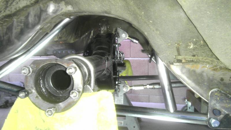

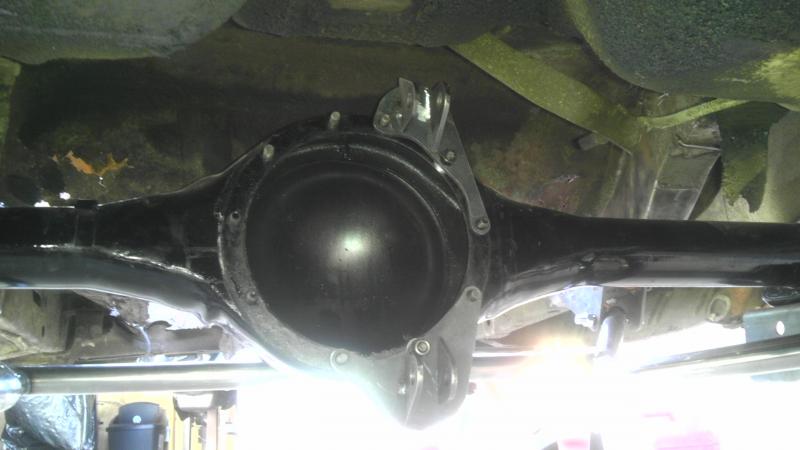

heres the mockup torque arm brackets for the 3rd member. theres another one that bolts in the spot of the pinion snubber to stregnthen the upper bracket. they bolt over the 3rd member. theres just enough threads on the stock studs for the whole nuts to grip to

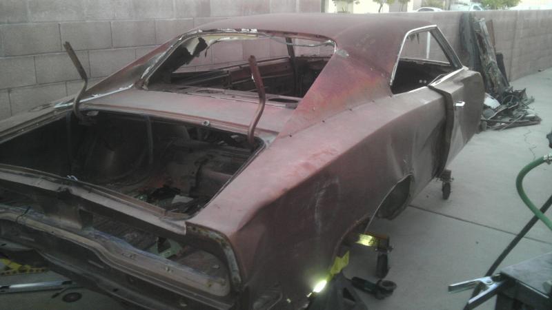

heres todays progress, i need to get the shock tower hoop to the cnc mandrel bender so it will make all the bends perfect and the same on every one with just the push of a button once we get it programmed. i have to get a tighter radius die for the drive shaft loop so i can finish the top rail on the torque arm bracket. also here is the stunt double, i think all im going to fix is the floor so i dont fall thru it...

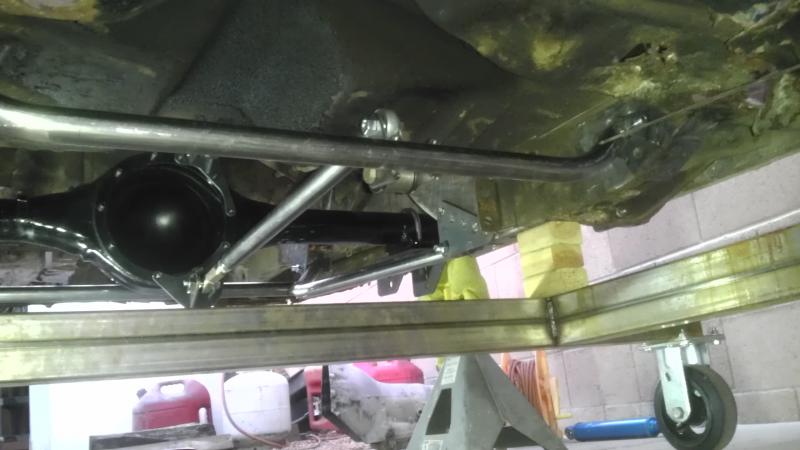

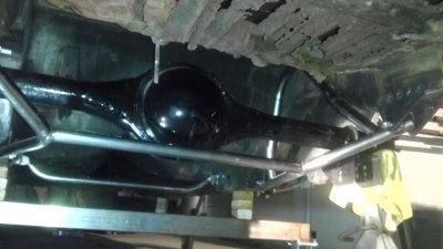

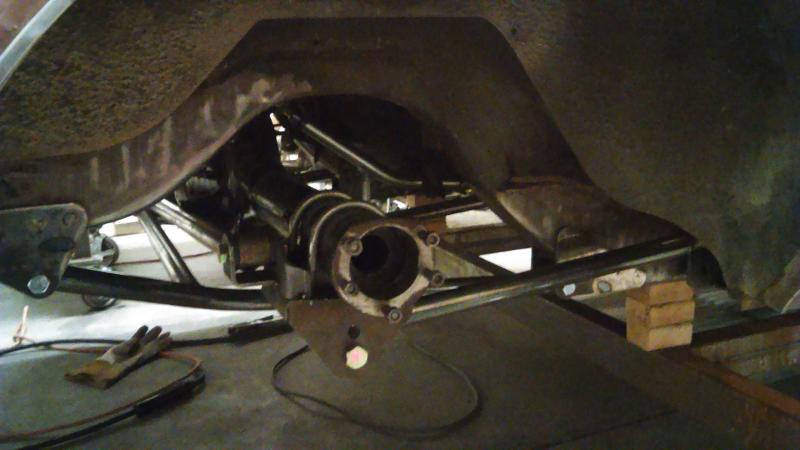

havent had much time to work on this car, but now workin on panhard and shock mounts
Why not gusset the rear axle and attach torque arms to gusset. The diff on the 8-3/4 is the weekest point in the housing and you just stressed it more.

the 8 3/4 is weak on the bearing carriers, a friend has blown 2 out on a 1500hp drag car. this is made to be a bolt on deal once you spot weld the frame brackets, im buiding 2 versions...this semi bolt on and then a light weight weld on with tq arm weld brackets as you mensioned wich is going on a few of my chargers. anyone can spot weld, that was the point is so anyone can install it.

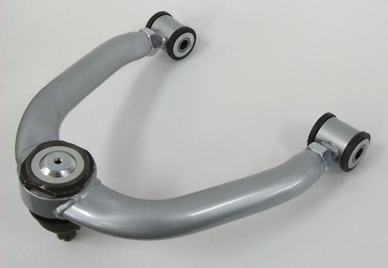

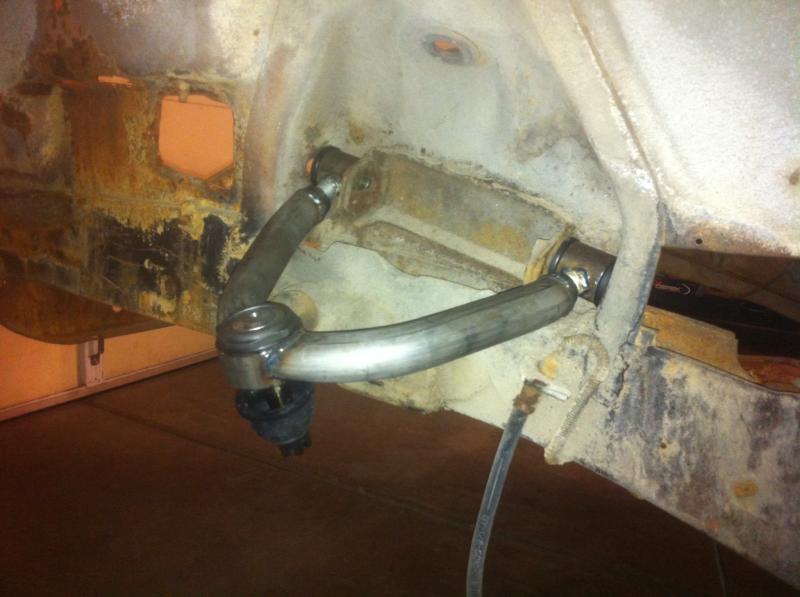

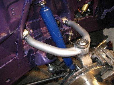

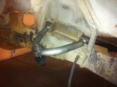

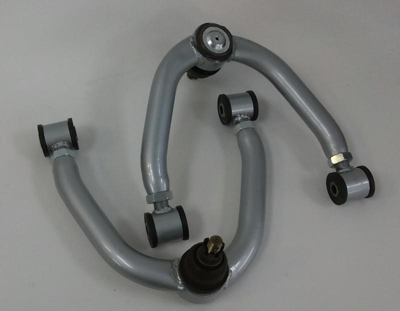

started on the front since im waiting for a few cad drawings to get cut, used my b body jig to make the front uppers for it, adjustable length and 3 degrees more casterfront upper.jpgupper2.jpg
why would anyone run an 8 3/4 with 1500hp.
can you share some pics of what the rear end looks like as a total unit?

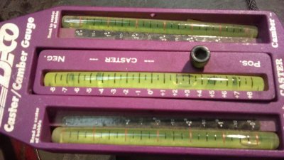

stock uppers set at 0 degrees camber was -2 caster, bolted my uppers on with cam bolts marked in the same location as stock ones netted me +2.5 degrees with alot of adjustability left. when i flipped them upside down (also swapped bj around) i was able to get +5 degrees at the same marked cam bolt location. +5 degrees is great for even better performance handling. fixed bad bj angles and made it where the bushings dont ride on the body, tightened up i was still able to move them with 1 finger. still waiting on cad drawing to finish rear k frame though.
