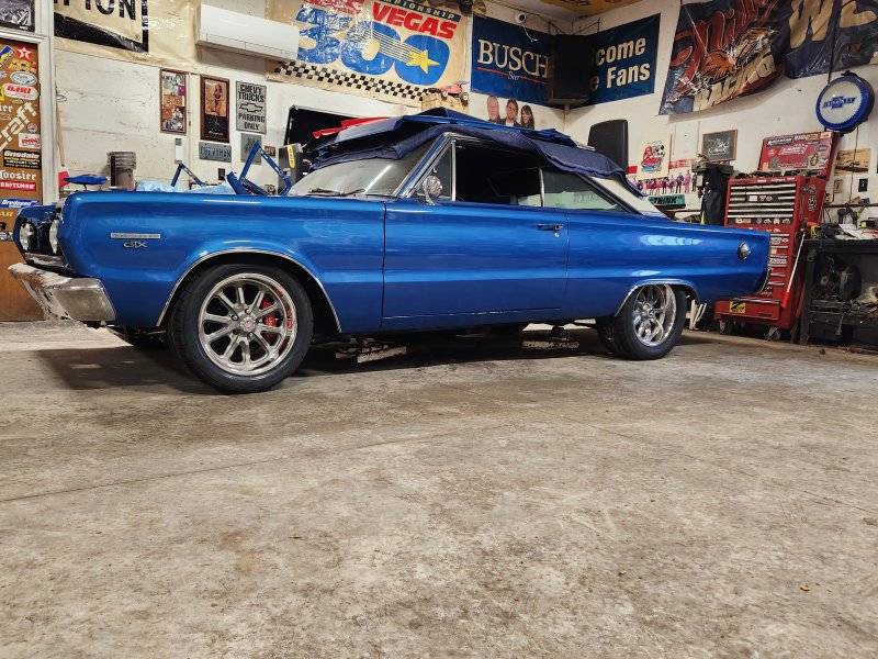

The car is a '67 GTX originally a 440 car.
He bought a 426 Hemi and a magnum force k member (which I'm not impressed with at all, but that another story)

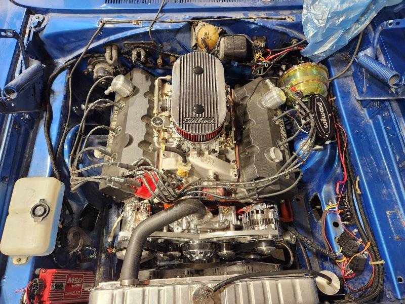

So with this combo the engine sits crooked in the engine bay...Ron @ magnum force says they are supposed to be this way, it's how they came from the factory. Is this true ?

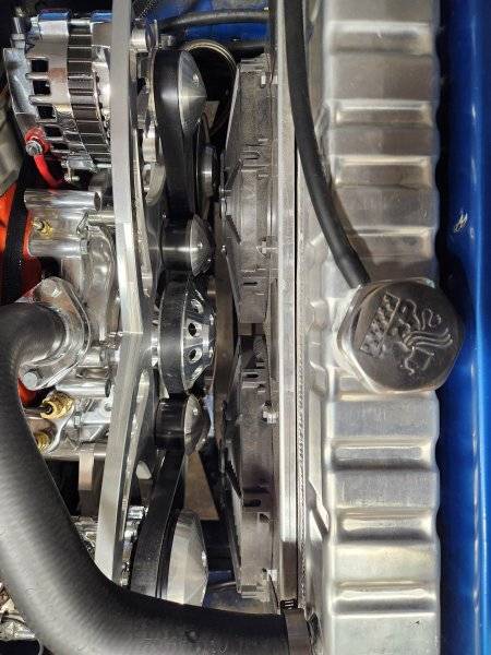

Problem is the tail stock on the trans hits the side of the tunnel... definitely no room to add the overdrive box he wants on the back. So... modify the floor? Cut apart k member and modify? What are you thoughts? Magnum force is no help, they not returning calls or emails. Pic of the car and some engine shots... hard to see the angle in the pictures, but that's what I'm dealing with.

Does this block have the hemi style mounting boss or wedge style ears. There were some blocks with the wedge style casted. If wedge style maybe the brackets are on the wrong side of the ears or on the wrong sides. My question is that with it that crooked how could the transmission bolt to its mount and cross member correctly???
I don't see that why it would not, being the trans is only located singingly at its rearest point, the front of the trans mimics the engine location/orientation when attached. The key would be how much slop/flex is in the motor mounts to accommodate any possible needed rotation of the motor (in plan view) to bolt up to the trans. How acceptable that is might vary.
I don't see that why it would not, being the trans is only located singingly at its rearrest point, the front of the trans mimics the engine location/orientation when attached.
[[[[[Problem is the tail stock on the trans hits the side of the tunnel.]]]]] Things can not be lining up that well with this happening. Dont need to be a rocket scientist to see that.

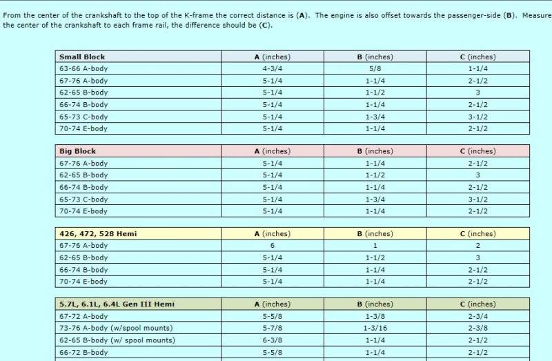

Buy a Hemi K member! Yes you need to modify the floor for OD. TTI has this chart, go to thier site if you can't read it.

The factory K members offset the engine to the passenger side for steering box clearance but the centerline is parallel to the vehicle center.
