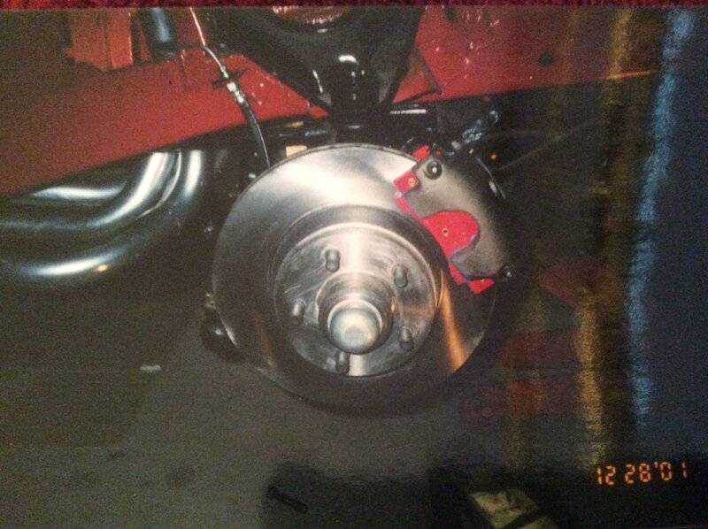

Problem with M/A Disc-O-Tec is the price of caliper brackets price. I did it 20 years ago $500/$600. Called junkyards in Wi, Minnesota and asked if they had the Make/model of cars that had caliper brackets. Sent them a picture of both C/B's and mark the pair I wanted. Should have asked for the bolts and pins, just in case.
