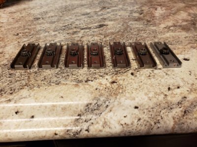

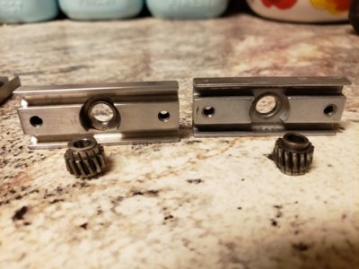

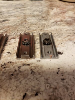

I know this is old but if you didn't get this working I have a fix for you. I had the drive gear and cable guide plate machined from case hardened steel. Just got 6 sets made and I'm test fitting them into my car today. Here are a few pictures with the original for comparison. These are not the same as the VW parts. Not even close. Other parts like the cables and some seals are though.
