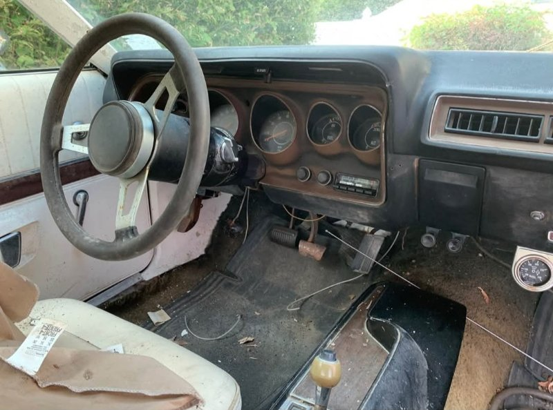

That's not an original 4-speed car. The 'clutch' pedal is for doing burnouts with an automatic - you can build up engine RPM's while simultaneously dis-engaging the torque converter.
When you're ready to paint the black stripes on the road, let that clutch pedal go.Saves wear & tear on the transmission.

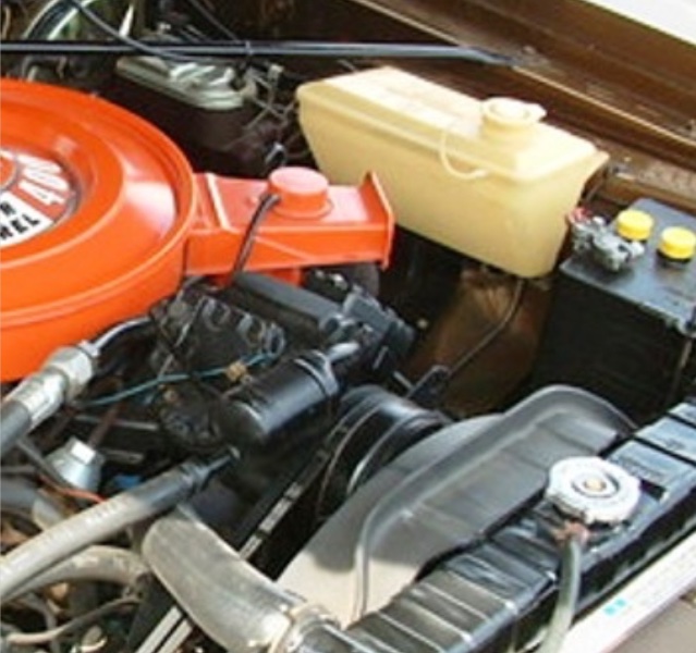

If it was a real GTX, which it is not as evidenced by the clutch pedal, I would be tempted to get it and use it to rebuild a true GTX sunroof car. It’s also not a 74 as evidenced by the washer fluid bottle. The guy is basically full of ****.Here is a parts car for you to scavenge...

Didn’t know that about the washer bottle. Thanks. I’ve searched VW forums and parts too. I already knew they had interchangeable parts. American Sunroof Corporation is the name of the company that manufactured the sunroofs for Chrysler.The washer fluid bottle is for 73/74 Cruise control cars.

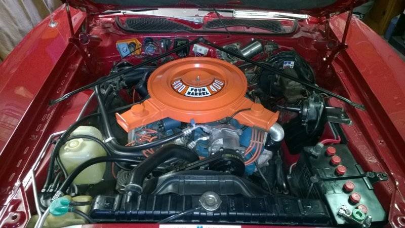

How was the cruise operated inside the car? A separate lever on the steering column?Yeap, 73/74 non cruise control cars got this bottle
But that location was used for the cruise control unit on cruise control cars, then the washer bottle changed its location to the one shown on the 74 RR advertisement

I do remember seeing a few “clutch-flites” as a kid in the late 70’s. By the early 80’s converters got better.View attachment 1944950
