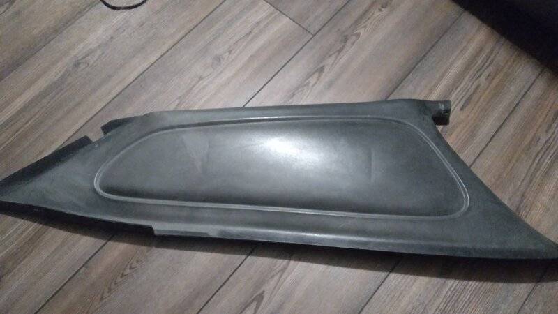

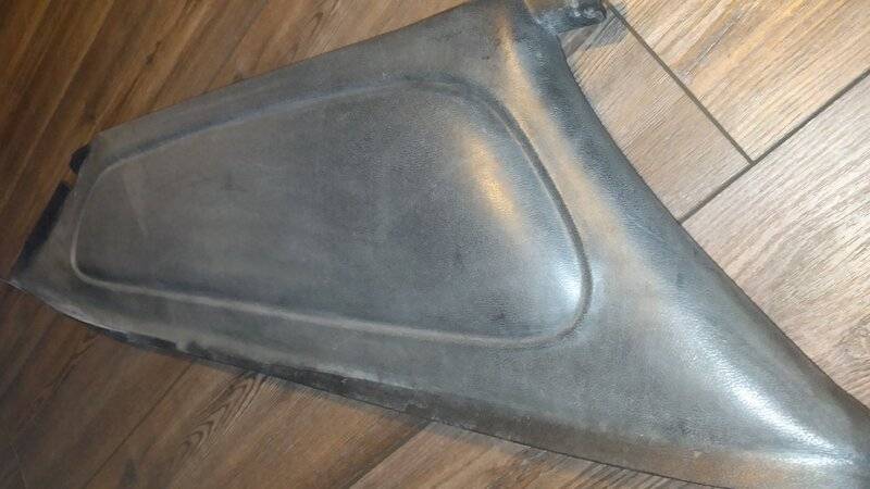

What are you guys doing with plastic in this shape? Just faded no chalking or crumbling....replacing isn't an option for now nor is Armor-All or equivalents. The lower door panels are the same....If using paint what looks good? Thanks!

Color Coat worked really well for meView attachment 1237615

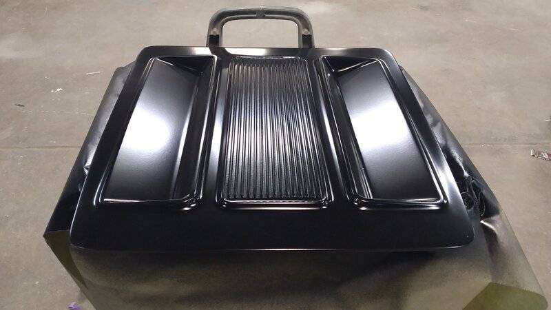

That's what 71Beeper used in the thread link Chi Town Runner posted. I like the look of it also. Just ordered 2 cans a little while ago. It looks very similar if not the same as VHT satin black ceramic engine paint I used on my 71 S. Bee hood insert
Cool, I think you'll be happy with the results! Hope it turns out well!
Perfect, they look new now! Nice job!!!

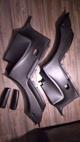

There was a part or two that I could only find in a different color, and that stuff actually worked well to make them black.

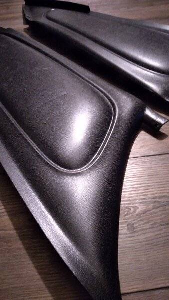

It sprayed nice and covered great. These were a dust coat and 2 med wet coats. 1 can for me to do the parts pictured. Only bad thing really was at near empty it spit too much for a uniform finish. Kept for in a pinch touch up. Dry time is nice too. Thanks for the tip!
Yep, the old end of the can spittles.
It's more economical to buy a pint if you have an entire interior to do.
