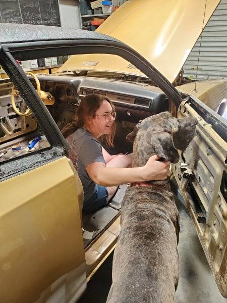

Hello! I am a few days away from installing the interior in my ‘74 Charger, and I’m finishing up all of the insulation. My question is, should I use heavy plastic, or the “moving blanket” type of insulation on the doors before the door panels? My car was gutted when I started the restoration, so I don’t know what was used originally. Thank you!

(Sorry - off topic a bit)... That's a nice looking pup you have (post #1). Is that a Fila?
