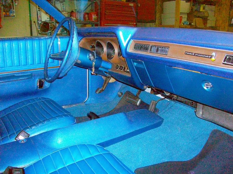

72 RRinterior.jpgI used the B5 blue SEM paint and vinyl products on my 72 Roadrunner when I had it and was very satisfied with how it turned out.
Not only is that a nice interior, 72*birdman, it also lets us know that you've been hiding it from us. Head on over to the welcome forum and say hi to everyone! :)

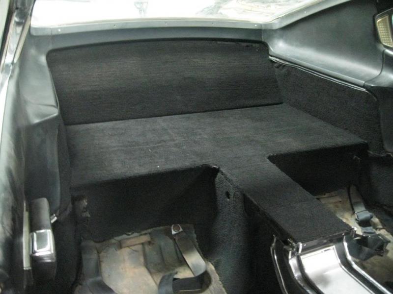

I painted the carpet in my Charger with SEM Color Coat. Poor mans carpet kit. Also painted the rear seats with it to match the new covers in the front.

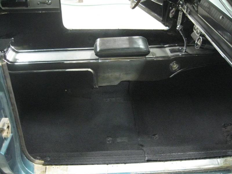

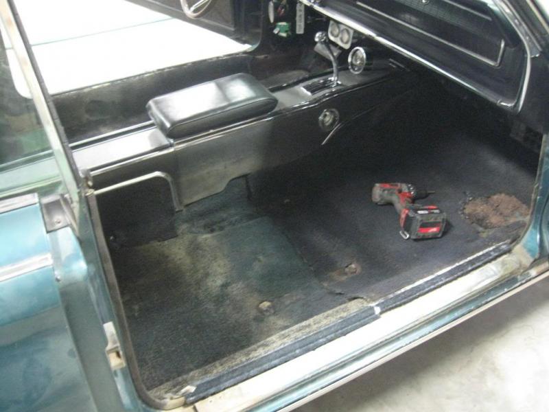

SEM Color Coat. Here is a picture of a finished panel next to one that wasnt done yet.

I used satin black 15243 for the seats, it matched the new Legendary seat covers. It's only available in rattle cans. For the carpet I used Landau black 15014 only reason I used that was because it came in quarts. Sprayed the whole quart on the carpet.
