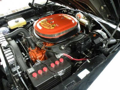

post up a pic of the proble,. i need to see this for myself.
