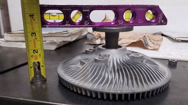

How long is the clutch you have? This one is from the Mopar Performance 'viscous fan' kit I think I got it from Mancini's years ago. 3.25 inches measured from back of mounting flange to front edge as shown

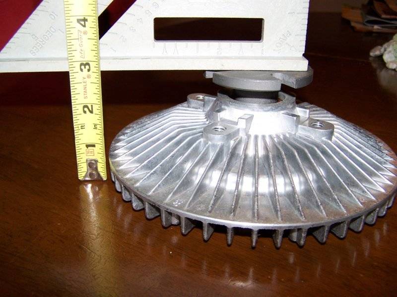

Here is a picture of the Hayden HD fan clutch #2947. It is 2-3/4" tall. It is the shortest one that they make for Chrysler cars. I'm pretty sure that the 070 fan clutch was the shortest one that the factory made. I believe that it is 2-1/2" tall.
The Hayden 2947 clutch is a thermostatic one and the 070 factory clutch is a torque style one.

You'd have to measure yours to know for sure. The RV one I'm using is about 1/4" shorter than the Mopar Performance unit in my above picture. The 2947 is the shortest one I've seen; shorter than my RV clutch and a good bit shorter than the Mopar clutch which is supposed to be a stock replacement. I have one of the 2947s too but the RV clutch got the fan as close as possible to the radiator without being too close, plus there's a a tad more room to get the bolts in the pulley. See how much room is between your radiator and the face of your pulley, you want a clutch that's about 3/4" or 1" less than that overall.
