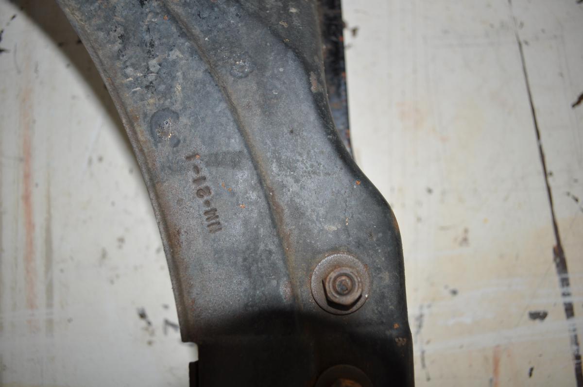

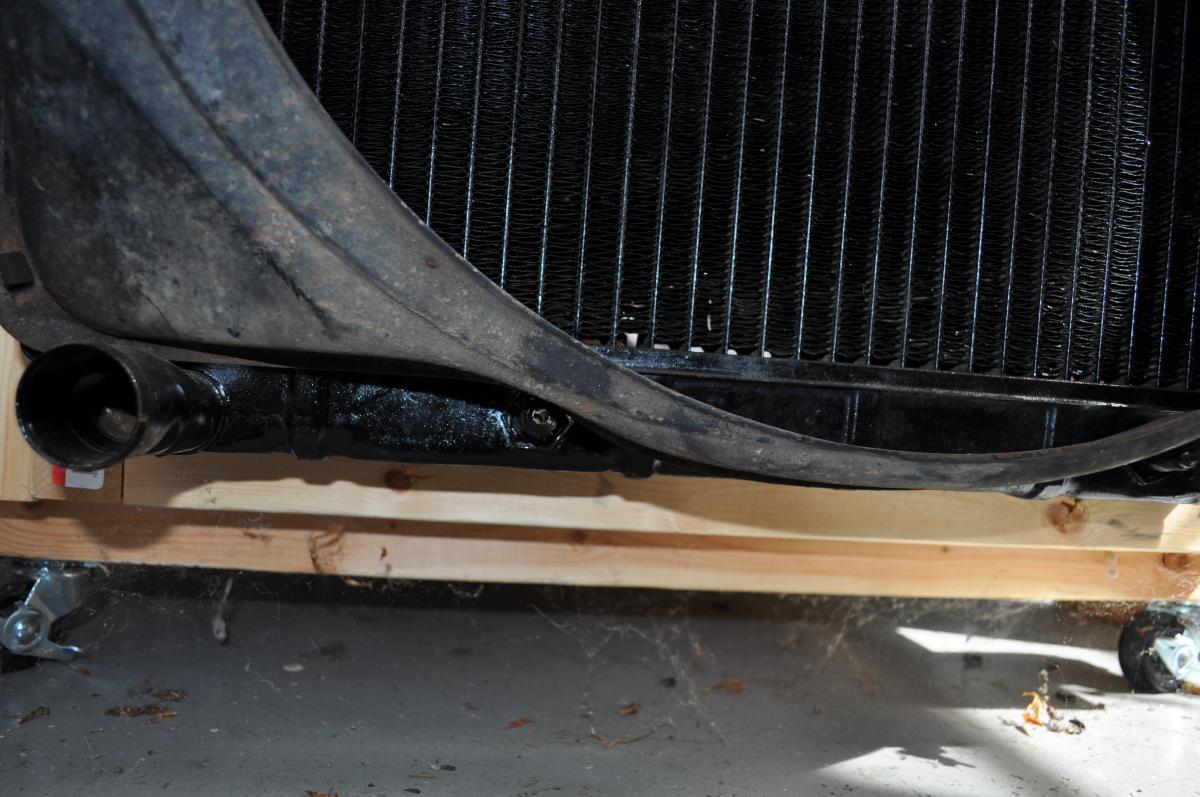

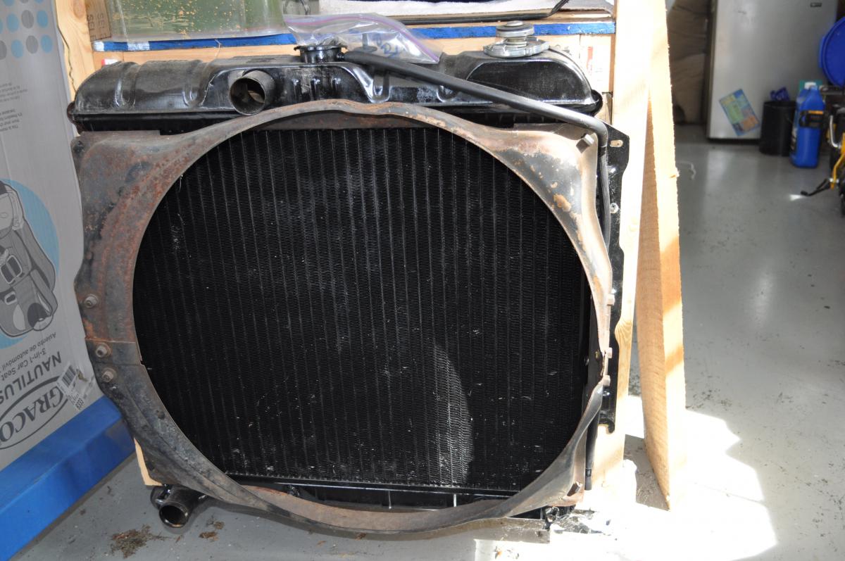

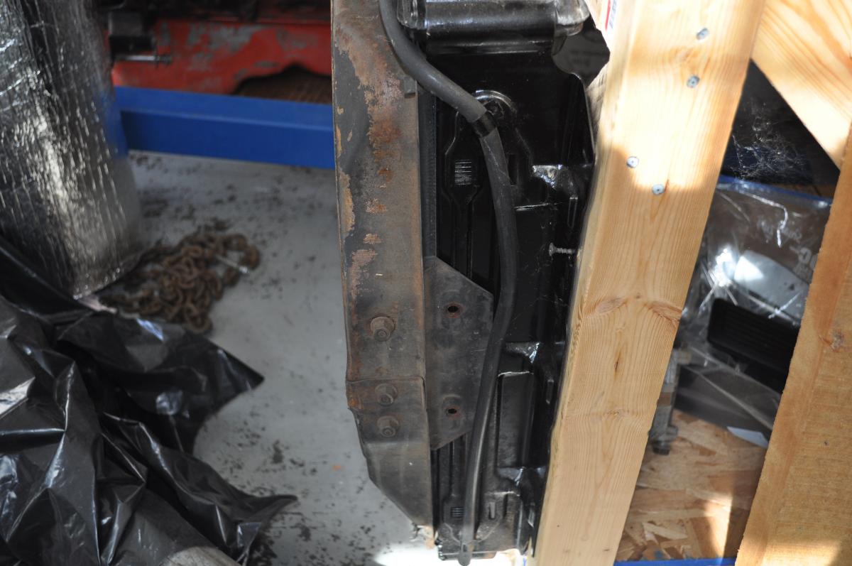

Just got this shroud. I was told it would fit my `66 Belvedere. While it's for a 22" wide radiator, it does not fit my `66. With it installed one way (see photos), it has some clearance issues. If I flip it over (no photos), it's even worse. One photo shows a number stamped in the metal. Maybe someone has a parts cross reference? The guy I got it from stated this came off a `65 Fury with a 22" radiator.
More pics

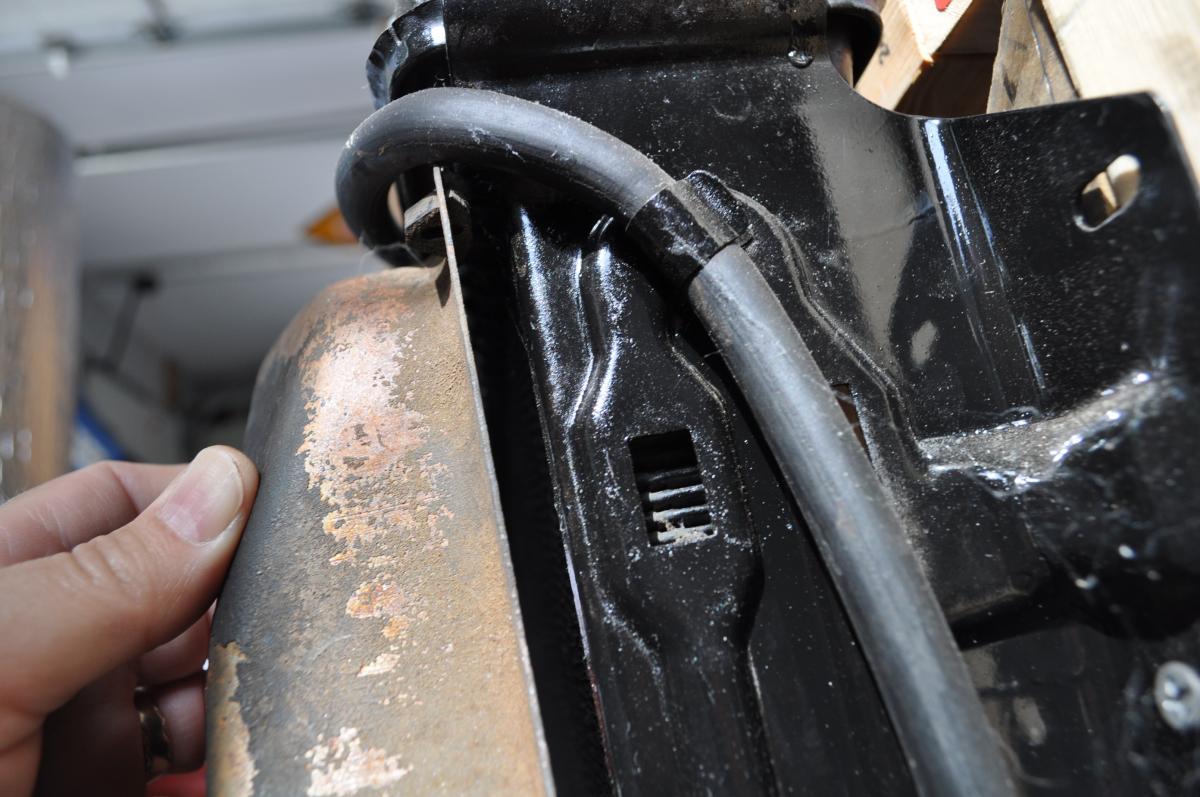

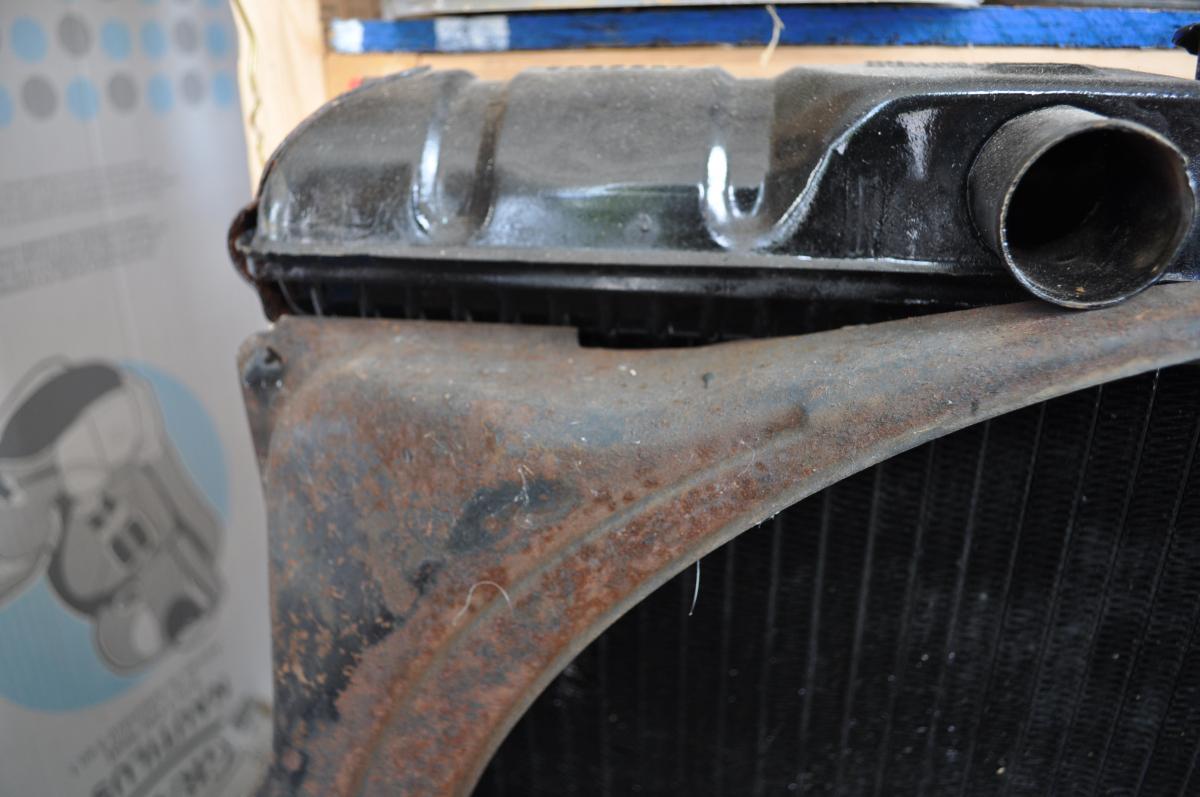

Side mounts should be at each corner for my `66. These are in the side centers. This one also comes in contact with the upper tank in the outer top portions.
P/N
The number stamped in is: NM-21-1
I think that is for a C-body, early 60's. B-bodies used 4 tabs to mount the shroud.
Wrong shroud...
Correct.... that is a C-body shroud.

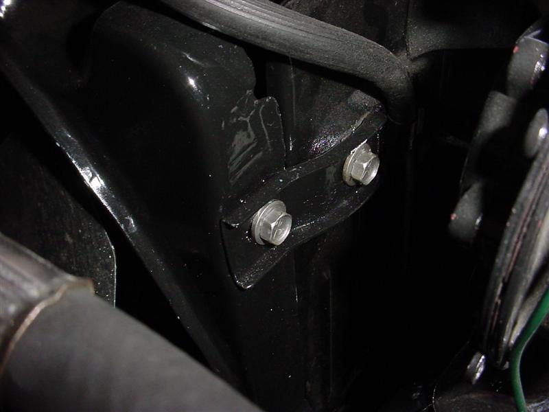

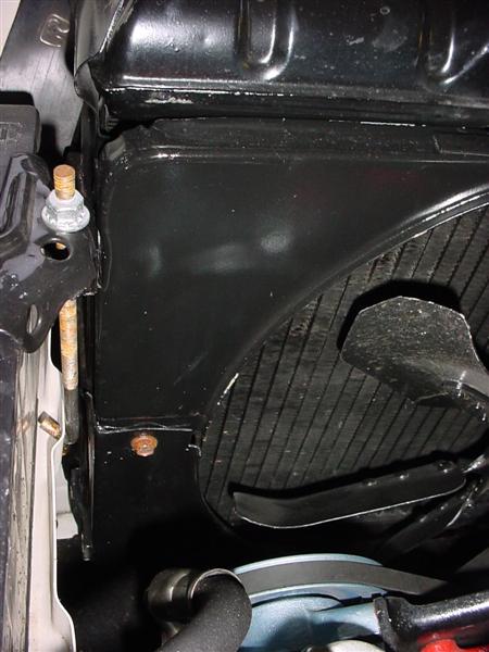

The B-body shroud mounts like this....
