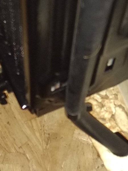

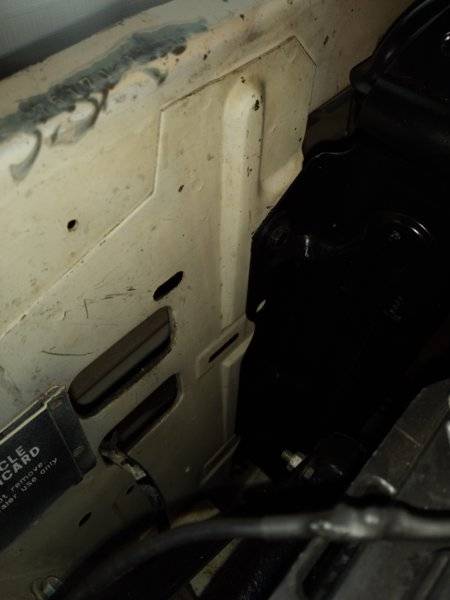

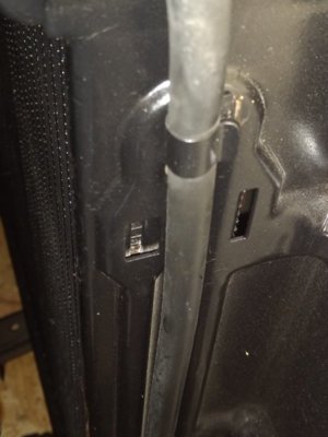

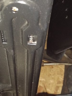

I had it re-cord with an extra row in it. Here are some pics of the side
IMG_20180331_121411401.jpg IMG_20180331_121351290.jpg IMG_20180331_121259468.jpg IMG_20180331_121320704.jpg
I bought the car with the 440 , it has the 318 radiator in . I would put a 26 in it but the support is set up for a 22 in
Have one just like it sitting around some where in original 3 core. Like stated earlier you are going to have to get creative if you really what a shroud.

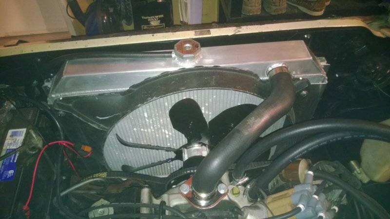

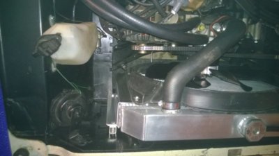

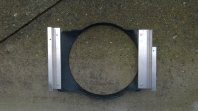

Some pictures of my setup in a 66 Belvedere, 440, with a 26" aluminum rad. It is a stock shroud, with some home made mounting "Z" brackets. I made the templates out of cereal boxes and had a metal shop bend them up for me after I cut them to the size I needed.
