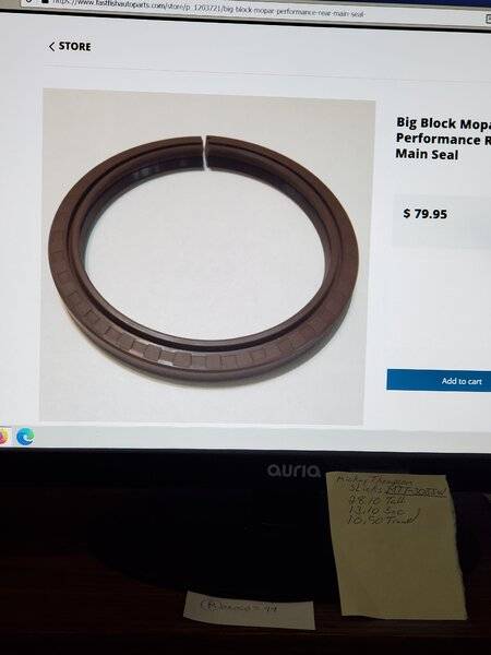

I've been reading everything I can on this site about rear main seal leaks I happen to have one and recently made it worse, I've read and seen and cried with the engine builder all those tricks I just ordered a fastfish one piece seal just wondering who has huge now and how it turned out for them this is only in regard to fastfish one piece seal.

i talked to jeff at fastfish he says you can push them in with crank in position with the parting line up at top 12:00 oclock, he says they work, i have read posts where guys said they have used them and they all have worked, just wondering if anyone has had a failure.

Awsome, how long ago, did you use any sealants on anything, some pictures i have seen on the internet show the seal with a flat bottom ( the area that touches the outer most seal retainer ) the picture thats on there web site shows the seal with a tapper on the outer most area, i forgot to ask jeff with there has been a change in the seal since it was first released because it definitely looks different.

Been a couple of years so I don’t remember exactly. I know I just followed the directions but for some reason with the crank in the car the cut has to be at 6 o’clock. Not 100% sure on that.
