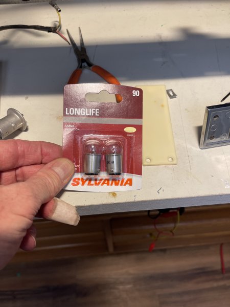

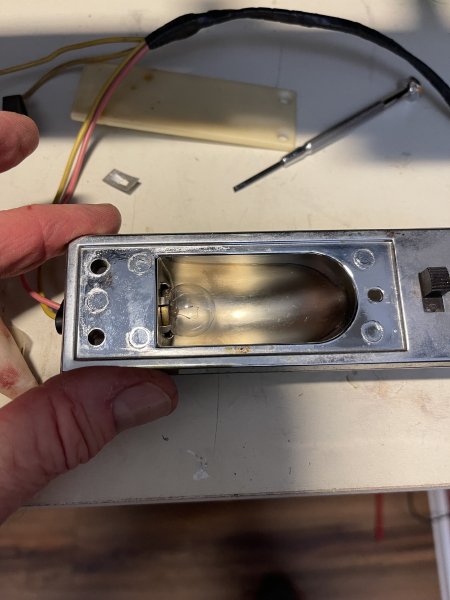

can’t grab and turn the bulb with my apparent fat fingers. Anyone know an easy way to get the bulb out? Can’t imagine doing this when it’s in the dash lol

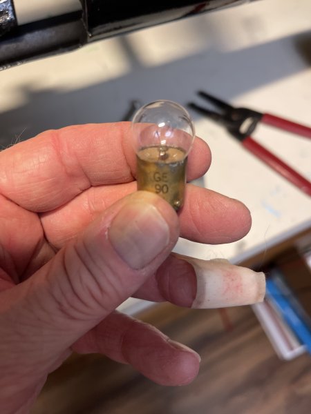

Oh and where can I get one of these bulbs?

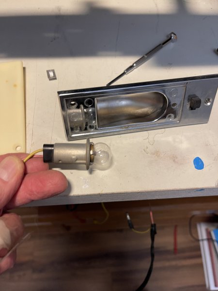

Love answering my own post. The socket pulls out for those that follow in my footsteps…..now to find the right bulb!
For small LAMPS like that - I use a short piece of Heat-shrink - the Raychem shrink with light glue inside is perfect for gripping the likes of indicator lamps etc.

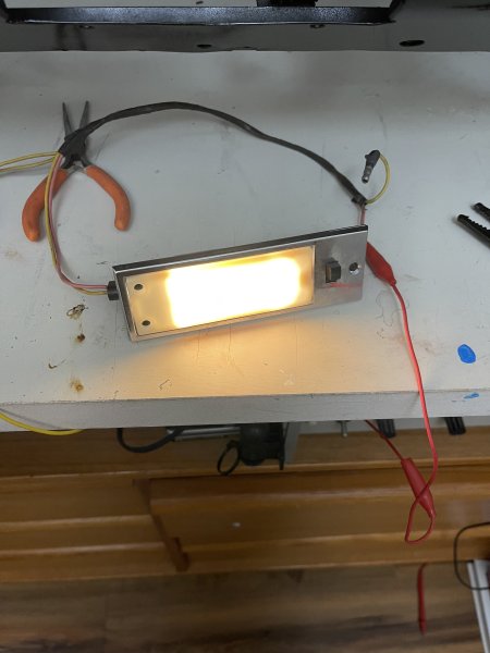

Bada bing bada boom! Good excuse to get the motorcycle out for a ride!!
