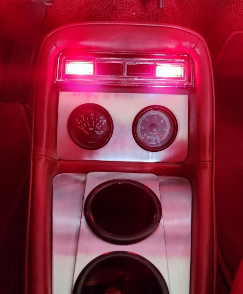

Plenty of times the fix was easy or at least easier than thought. Nice as it sort of balances out those times when it wasn’t. A more recent hassle was one of the indicator lights on a light bar in my modified console burned out. Well, getting to the housing is a supreme bitch, but figured it just needed a new bulb. They were likely the originals in the console from a late 70’s car. When I got the housing out, noticed some heat damage. It had burned out during a car cruise where we were locked up in traffic jams for 45-minutes with my foot on the brake. Those old bulbs get hot. When I inserted a new bulb, it wouldn’t work. Put in another just in case, and didn’t work. The remedy I then figured would be trying to rewire the housing to an unused light. Not something I was looking forward to plus its location wasn’t my preference.
Somehow got the idea of getting LED bulbs. Put one in that non-working socket and it lit up perfect. Replaced the others with LED bulbs and all good. They can stay lit and never get hot. A hassle to do this job, but tons less with those LEDs.
