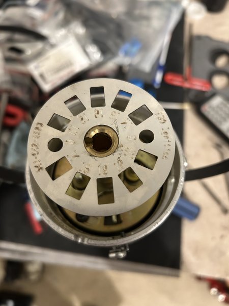

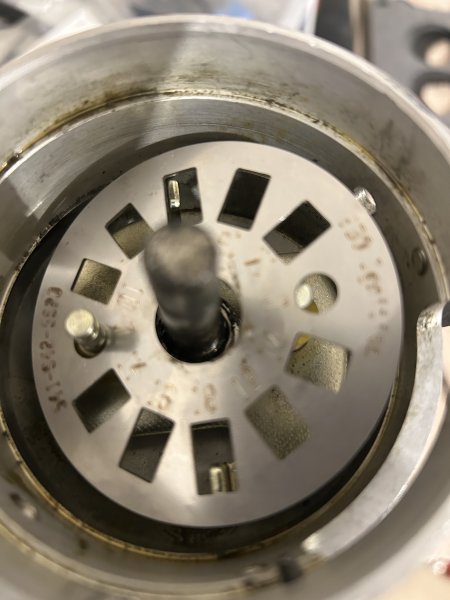

So back to this issue. Is the limiter plate only meant to be used with an original Mopar dizzy and NOT the MP electronic dizzy? Are the two different internally, because here’s a photo of the dizzy plate that won’t go over the dizzy shaft plus the mounting holes sit out wider than the MP electronic dizzy.

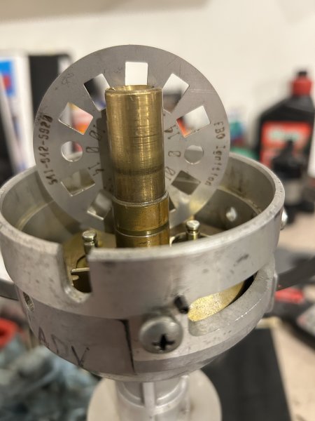

My bad, that gold colored assembly comes off. But the plate still doesn’t fit, mounting holes are too wide for the MP electronic dizzy.
What’s an electronic unit? Like a Firecore and not the MP Electronic conversion dizzy?
A factory installed distributor that took the place of points style distributors since the early '70's.
Your distributor has a mallory style advance set up. It's set with the air gap from the plate and the upward pointing tabs in the window. You can set it with keys or use a drill bit shank of appropriate sizing (hillbilly approach as I never buy those keys).
Those plates don't work with the MP/DC electronic units. If the rotor shaft has a bronze color, it is a no go on them working.

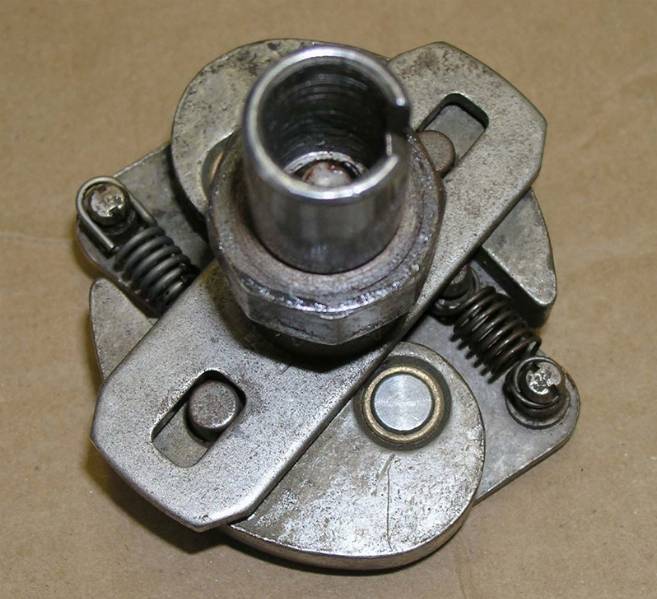

It's for one that look like this.
CB, thanks for clear cut explanation. Now I get it.
