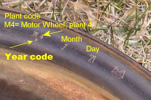

One way to help determine if that could be true is to see how the date code on the wheels compare to the SPD of the car. If the dates on the wheels are significantly AFTER the SPD of the car...that helps answer your question.

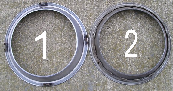

Also...check the trim rings. They should have a raised 'lip' on the inside of the ring and four clips on the back of the ring. Style 1 in the picture.
