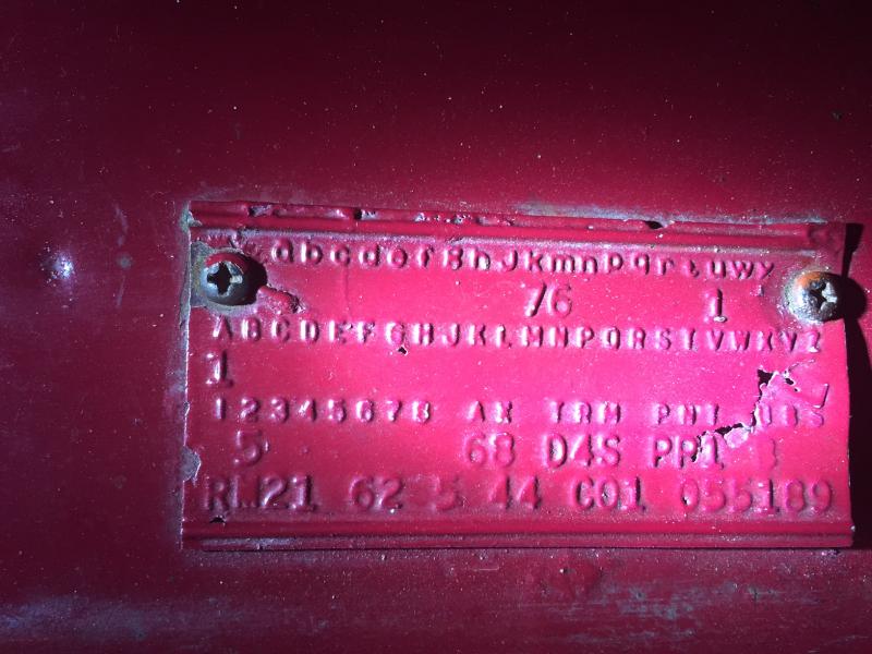

Been having some issues with decoding my fender tag...For my 1968 Road Runner
I went to a 68' decoder, but I couldn't enter all the info.
Perhaps someone here can help me ?
Thanks !!
It always takes a few tries to get everything lined up correctly, but here you go....
http://www.mymopar.com/index.php?pid=85
CAR: Plymouth RoadRunner 2 Door Pillar Coupe
ENGINE: 383cid 4-bbl HP V8
TRANSMISSION: 3-Speed Automatic
TIRES: F70x14 Red Side Wall, Steel Belted
BUILD DATE: December 01.
AXLE: Unknown Axle Code
INTERIOR:
PAINT:
OTHER:
MOLDINGS:
25: Drip Rail Mouldings
ABC OPTIONS:
A1: 26in Radiator
abc OPTIONS:
k7: Passenger Outside Manual Mirror
m6: Driver's Outside Remote Operated Mirror
u1: Sold Car When Built (Somebody Ordered It)
