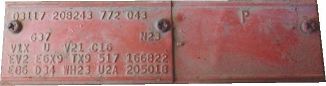

Does anyone know what the P on the second tag means?

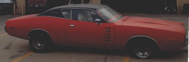

This is a 1972 Base 2 door hardtop with a 440 HP. There was not supposted to be a HP in 1972 but this car was built at Lynch Road, special order. Has all the extras, chrome bumper, front disk brakes, Ralleye doors, Ralleye front end, Ralleye rear end, and full vinyl roof. Can not get build sheet but has original fender tag.

That is a very nice car!

Doing a quick search
WH23:
Dodge Coronet,Charger
High
2 Door Hardtop
U2A: 440 280HP(net) or 290HP(net) 1-4BBL 8 CYL
1972
Lynch Road, MI, USA
205018: Sequence number
E86: 440 cid 4 barrel V8 (High Performance) 375hp
D34: Light Duty Automatic Transmission
EV2: Hemi Orange Exterior Color
E6X9: Trim - Unknown, Vinyl Bucket Seats, Black
TX9: Black Diamond Int. Door Frames
517: Build Date: May 17
166822: Order number
V1X: Full Vinyl Top, Black
U: USA Specifications
V21: Performance Hood Treatment
C16: Console w/Woodgrain Panel
G37: OS Dual Racing Mirrors
N23: Electronic Ignition System
03117: Unknown
208243: Unknown
772: Unknown
043: Unknown
There was not supposted to be a HP in 1972 but this car was built at Lynch Road, special order. Has all the extras, chrome bumper, front disk brakes, Ralleye doors, Ralleye front end, Ralleye rear end, and full vinyl roof. Can not get build sheet but has original fender tag.View attachment 728947
You have a Rallye package on a WH23 with optional 440. One of about 3,431 cars shipped for sale in the US with the Rallye Package. About 620 WH23 cars shipped with 440-4 Automatic. Nothing on the tag indicates a special order car. Appears to be a easily available Rallye Charger with 440 in a desirable color.
Nice find.
