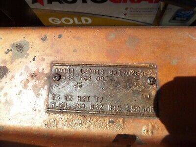

Fender tag. Decoding help request
Pikser
7:07 AM
May 23, 2015
305
540
Houston
tried a number of decoders I have used in the past but could not get them to work?
1969 road runner coupe with 383, auto, built on nov.15, 1968. It was painted copper metallic with a bench seat, and a 26 inch radiator k
The letter after the R looks like an M to me, which would make it a R.R. If it is an H then it would be a sattelite
The 643 at the top indicates a 3.91 sure grip 8 3/4 rear end. The 093 are the last 3 digits of the trans part number.The 926 are the last 3 digits of the engine assembly which is a 383 with 335 hp.
RM21 = Road Runner post car
E63 = 383 engine
D32 = automatic trans
T5 = copper metallic exterior paint
H2T = high trim grade, vinyl bench seat, saddle tan
T7 = dark bronze metallic upper door frame
26 = 26" radiator
