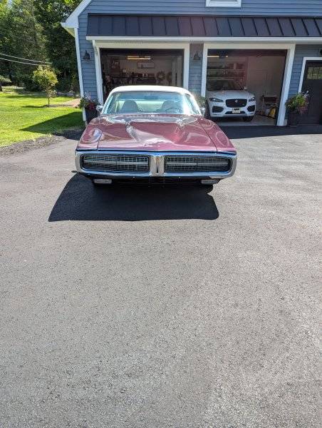

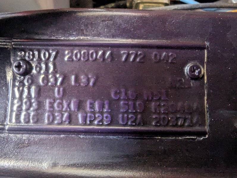

I just purchased a 1972 Dodge Charger SE 440 Magnum. The paint code reads 293 which I believe I was told was car #293 for a Special Factory Ordered Paint. I'm just wondering if anyone can figure it out. Thanks
Looks like it might have been a white car - possibly a special run of a different shade - and possibly pinstriping? EW1

Car pics would be nice. :thumbsup:

Special order paint code.
This car was painted whatever shade code 293 represented. It has nothing to do with counting anything.
The K VON was used to help designate Special Paint cars.
Did you find a broadcast sheet?

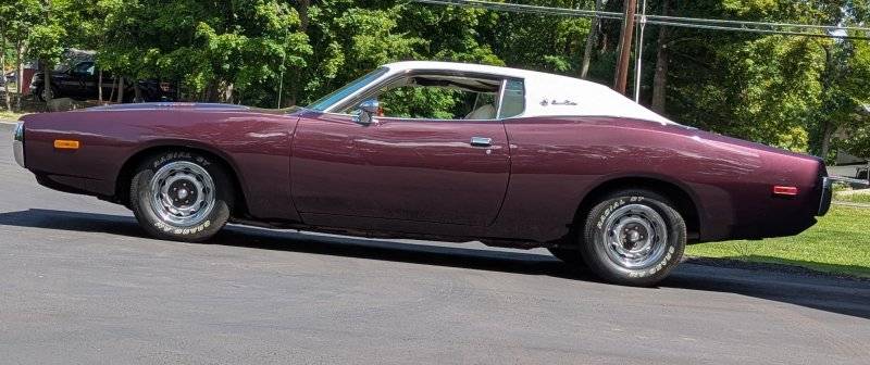

What color does it appear to be?
I was told by a knowledgeable Mopar person that the 293 represents the 293rd Special Factory Ordered car for Special Paint . Current color of the car. Not sure if it's the original color or not.
DT-3353 Maroon 1972 Truck Color so far looks the closest out of everything that I've looked at Mopar wise.

In the interest of time, they were wrong and I'm sorry for that.
There's no shred of evidence to back up that assertion. There would be no reason to track and code that across all plants.
IF that were even remotely true, due to the number of 'cop cars', fleet cars and typical 999 paint code cars Mopar produced, the number of special paint cars would run into the thousands. We do not see that reflected on tags. It really strains the imagination to believe that this car with a May 19 scheduled date would be only the 293rd special paint car for that year out of the hundreds of thousands of cars already produced.
It's simply the color used on that car as coded by Lynch Road. Other plants simply coded 999 for special paint colors and not the actual shade. IF it was something that was that important to track and code across plants, we would see the tracking number used across all plants. We don't.
What we do see is individual plants, like Lynch Road, using alternate paint codes instead of, or in addition to 999 codes, on their tags. Lynch Road has a history of doing so by using codes like C37D (Petty Blue) C673 (?) C415 (a green), 148 (pink), 293, 324, etc.
It is a special paint car. But we do not know from the tag what color that actually was. It could have been a color that was only available on Imperials that year. It could be a color that matched the dealer's teen age daughters eyes. It could be a special corporate color requested by a fleet buyer. We simply don't know.

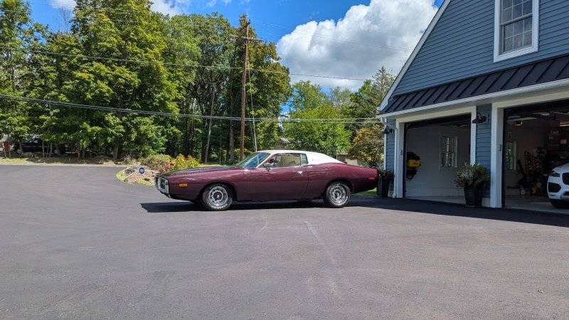

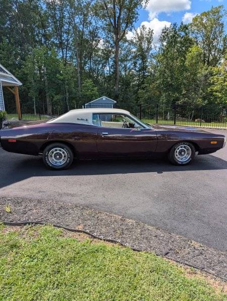

Beautiful car.
That is a nice looking car as is imo. Not that it really matters now because it has such a nice paint job on it, but if you do some investigating inside the trunk, under the carpet, behind the interior panels, you might find what the original color was. When I do a color change, I put the car on a rotisserie and blast every stitch of the original paint off. But I would bet that the majority of people don't do that and there will be evidence of the original color somewhere.
Thanks for all the comments and help. I think I'm going to leave it this color and whatever the original color might be so be it. It's a 440 Magnum car with matching numbers so it's already rare for that year. Thanks for all your help.
