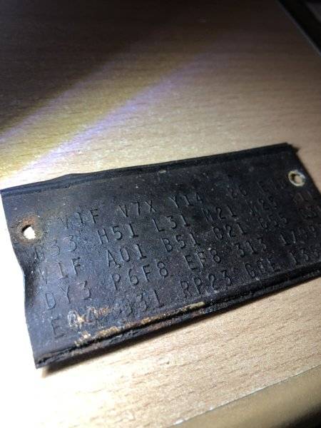

My fender tag is rusted. Whats the best way to restore it? I was thinking muriatic acid bath but wanted to hear from you gents that have done it successfully or know someone who did. My luck the acid would disolve the whole thing lol.
Thanks MF
Evaporust is very gentile. Won’t eat metal like muriatic. Works better in warmer weather.
Glass bead blasting is nice also.
How bad is it?

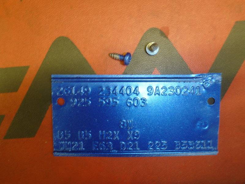

I media blasted mine with glass and repainted and it came out mint.
I did glass beading as well. Dusted with sealer and lightly painted, one coat clear. To much material is not good, you lose the detail quickly. Original appeared to a coat or two of the original single stage. I saw no evidence of primers.

Baaaad to the bone! Not sure I guess I will find out lol
I do not recommend muriatic acid (20% hydrochloric acid) or Evaporust (phosphoric acid, not sure %). IF you can find it, what you should be looking for is oxalic acid. It will eat iron/steel rust and not touch the metal at all....it won't even take off the paint. You'll need about a 5% or so solution, use distilled water & let it soak for several days up to a week....then rinse, dry & repaint or the bare metal will rust again. HOPE THIS HELPS!

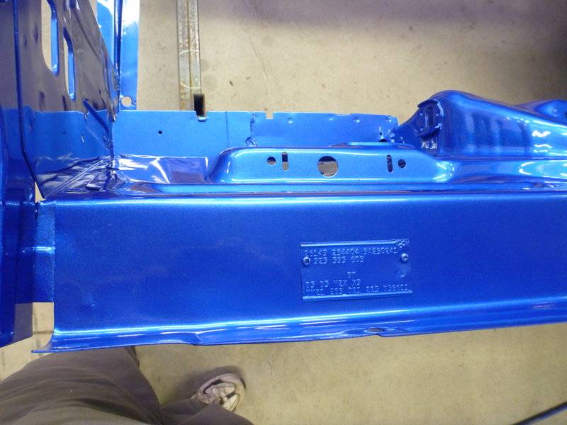

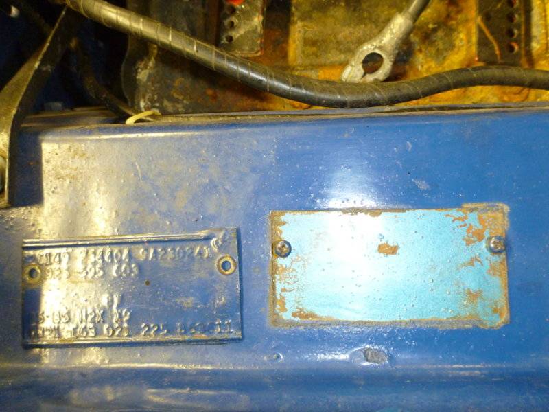

Wasn't your tag originally painted on the car? I can see where it was lifted....That one screw should be the phosphate look......
I can say I have not left parts in ER over a week let alone a month but that's funny the size changed that much....
My tag was originally hung from the visor AFAIK coming down the Lynch Road line and probably got very little paint. No bends,, ding in corner is inspection stamp. Inner fender had FULL B5 paint under it when I removed it. Previous repaints of the car never had the tag removed. Not sure how they did screws.. both painted or both bare if they hung tags.
Man that one corner just looks like it was lifted.......
My X tag was hung which was at LR....
The screws were installed prior to paint on cars that had the tags hung from the windshield area....They were not screwed down all the way of course but enough to keep them in place.....
