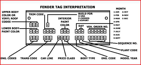

Maybe this will help, not sure but let's see?
http://passion4mopars-moparbodystyl...08/1969-1971-fender-tag-codes-code-years.html
Good info Passion, but he's specifically asking about the first two digits of the order number. Any info on that? "I" don't have a clue :edgy:
