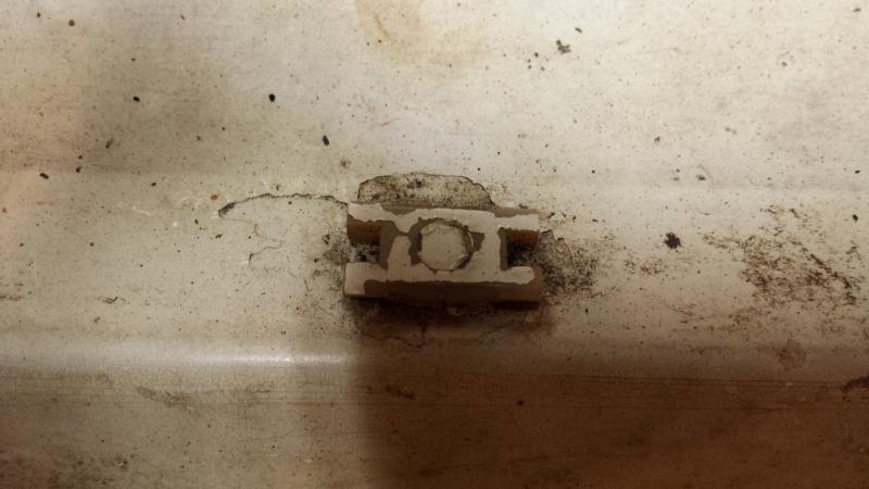

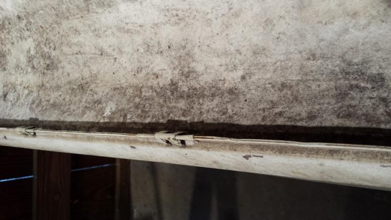

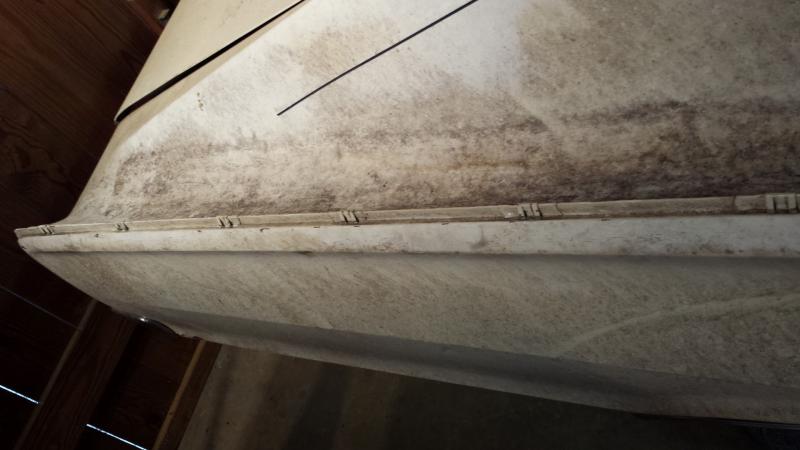

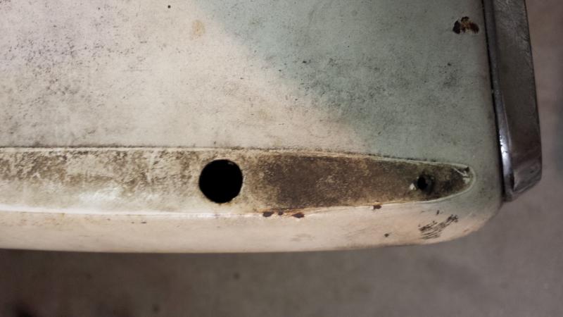

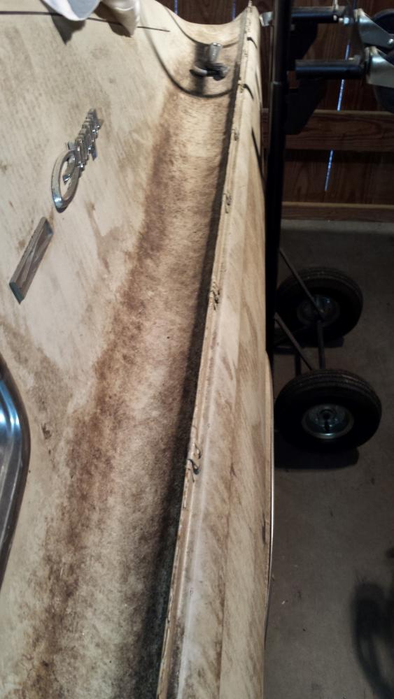

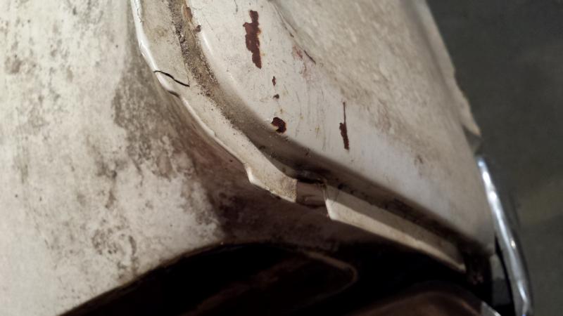

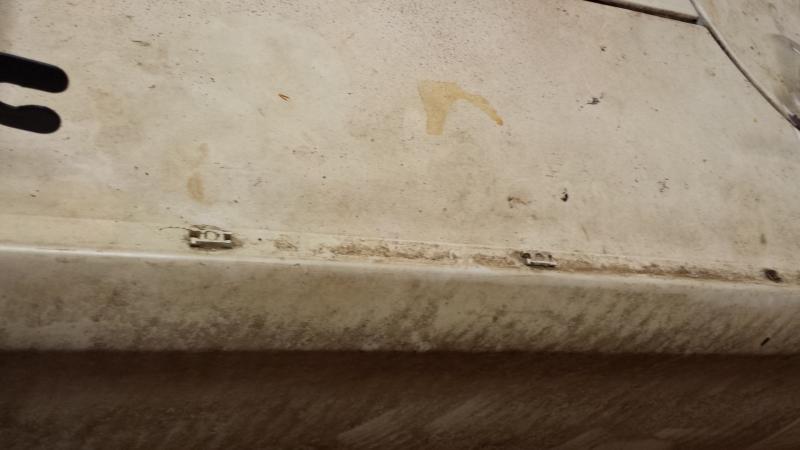

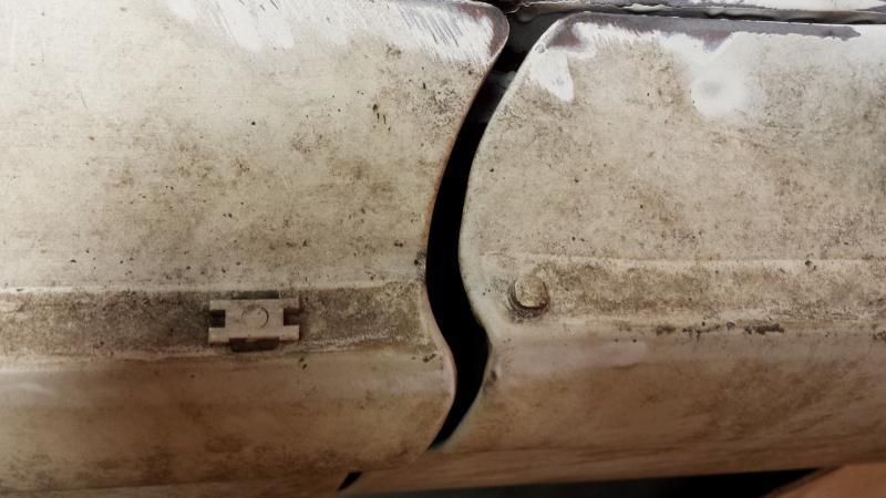

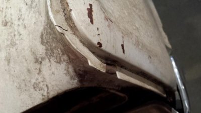

Pictures are worth a thousands words so I went out and took some for you.

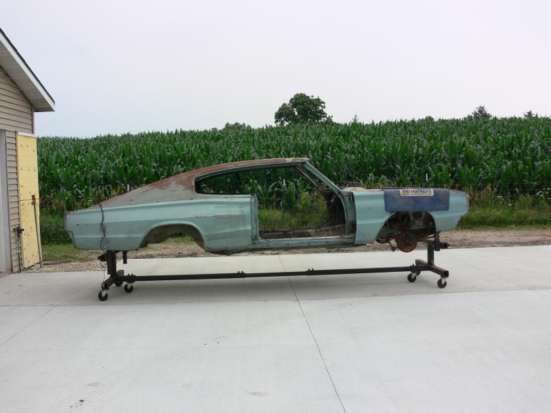

Here's one that I plan on removing the seam and welding it up.
If you are asking how to get it off, very carefully if you are planning to reinstall it.
They didn't plan to take it off. There is a screw under the front I think.

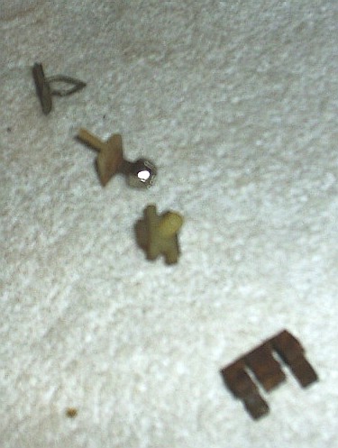

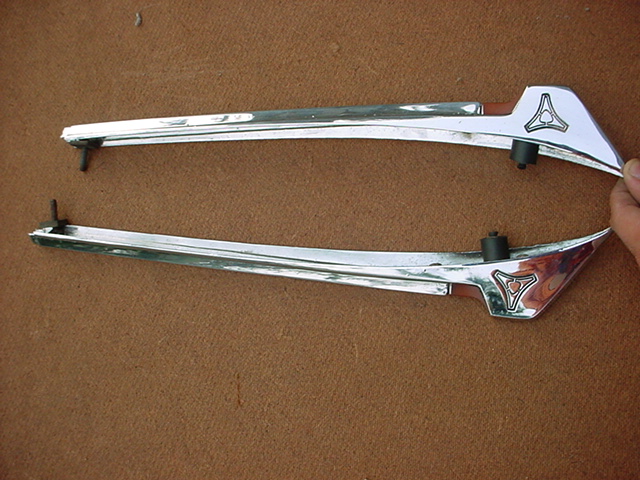

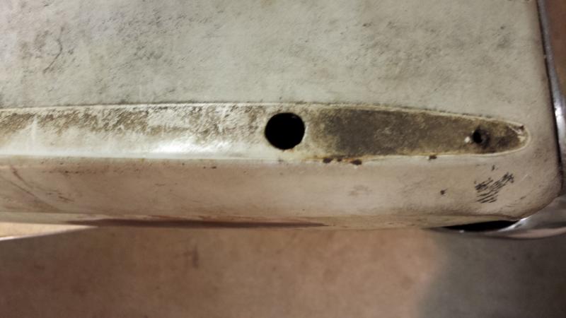

Depending on if it is a 66 or 67, the front trim is different. And I have seen a couple clips differences between the two years, otherwise it is all the same. 67 had the fender tip indicators, 66 did not. Those indicators come off with a screw in the very front and then a nut underneath in the back (pic). 66 was just trim.
Otherwise I suggest if you don't have a proper tool a piece of smooth plastic. This sounds crazy but I use an orange peeler. It is plastic with a rounded point and sort of curved to get under the peel skin. Works great on the trim to get underneath and pry up.

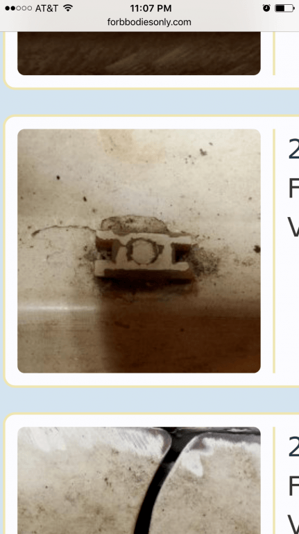

Now contrary to the pictures shown, there "should" be a stud and a nut on the end(s) of the fender trim and both ends of the door trim. Otherwise the clips should be the same.
The rear is another animal ... different clips but again they just pry off. Depending on how long they have been on there they may be stubborn but they just grip the 2 pieces of metal that come together and stick up where the quarter is joined with the roof.
Oh, it's a stud on the end of the front fender?
Been so long since I took it off, I forgot.
But that sounds right. I just know there was the small hole in front of the big hole which is the turn indicator.

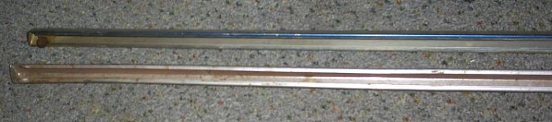

Also need the chrome strip that goes on top of the right rear fender the one I have is bent up. Thanks again guys you have been a big help to me

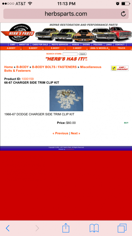

Ok call me crazy but just this summer I put ordered a kit that had all the peak moulding clips and the plastic clips for a 67 charger I did the stainless on. Now it's back from paint and of course I can't find anyone selling this "kit" more importantly I need the plastic clips that go under the door and fender trim that have the plastic pop on river type middle. Need them for both sides asap. Anyone?
Tom at rt specialties says he can dig up a set to overnight to me thankfully
