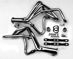

I wonder if the A-Body BB fender-well headers
would fit OK on a B-body & BB application
Dougs use to sell some
I can't remember the costs, part #'s
or whether they were for an A-Body or B-Body
or both body styles

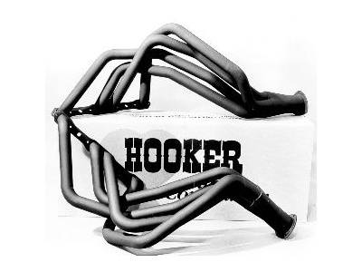

Hooker still sells some for the A-Body BB applications...
#520-5215, $593.95 IIRC on Holley/Hooker website
I think Jegs & Summit even sells them
Exhaust Hooker Headers BB A-body Mopar Fenderwell exit $593.95 #520-5215.jpg
The Hookers other than the MC & the brake-lines
{you'll no doubt have to move anyway, regardless}
I don't see why they wouldn't work,
{I'm sure someone correct me If I'm all wrong}
should be really close as far as engine bay widths
engine set backs etc., my best guess within an 1" or so
in either size or direction, front suspension points shouldn't
{?} be much different location wise too...
I know they have others for the
67-69 Barracuda's/70-75 Darts/Demon/Duster too
several different part #'s,
"I assume" in different tube 1-7/8" to 2" or collector sizes/lengths
#5205HKR {painted} #5205-1HKR, #5215-4HKR,
#5215-3HKR, #5215-1HKR, depending on coatings etc.
the #5215HKR 2" tube 43" long 3.5" collector
{"painted" cheapest listed #520-5215 one on Jegs/Summit in the photo}
some aren't cheap $800-hi $900+, let alone almost $600
