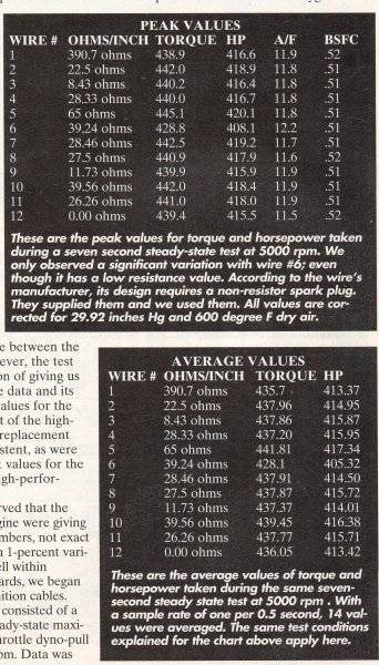

Here’s the best you can get, I don’t know how fast they ship.
What makes them the 'best'? Lowest resistance [ ohms ] does not mean the highest hp, because these wires also have inductance & capacitance.
