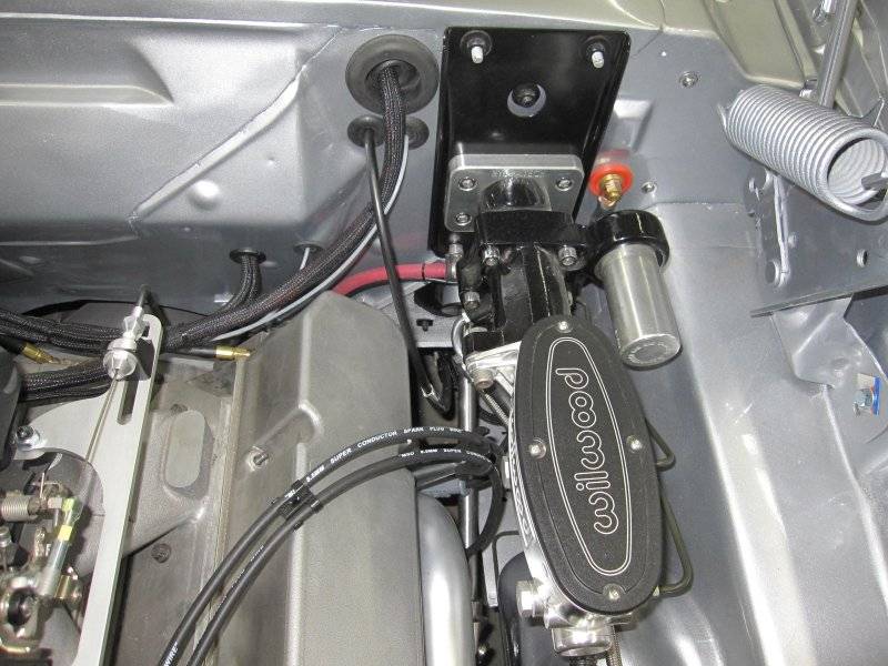

Was hoping that some of you fine individuals might be willing to share some pictures of how you penetrated the firewall to install the massive wiring harness for the Fitech six barrel setup. Thanks as always
Probably more work than you might want to undertake but, I had a large harness with my Fast 2.0. Welded in a patch and drilled 3 holes in the same area. Of course, the rest of the front wiring was routed through the right fenderwell.
Mike
I'm looking to re-do my FAST 2.0 harness with military style 38999 bulkhead connectors, but using the cheaper non-military spec versions (same shell size and pin size/layout, but not as expensive.) My firewall is already messed up from the aftermarket A/C lines, and the old Edelbrock EFI harness holes, so not a big deal to put more holes in it :BangHead:

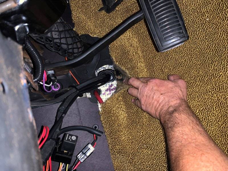

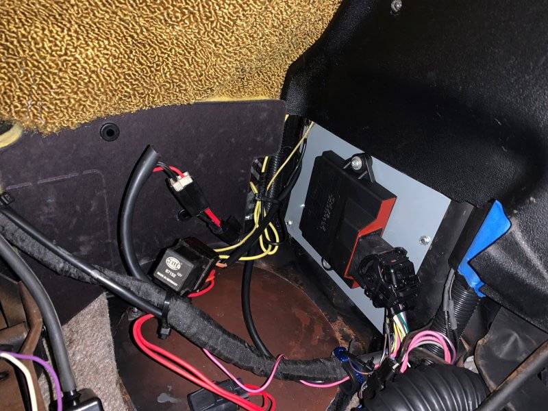

the oval hole for the clutch rod is where i ran my harness for my pro-flo
