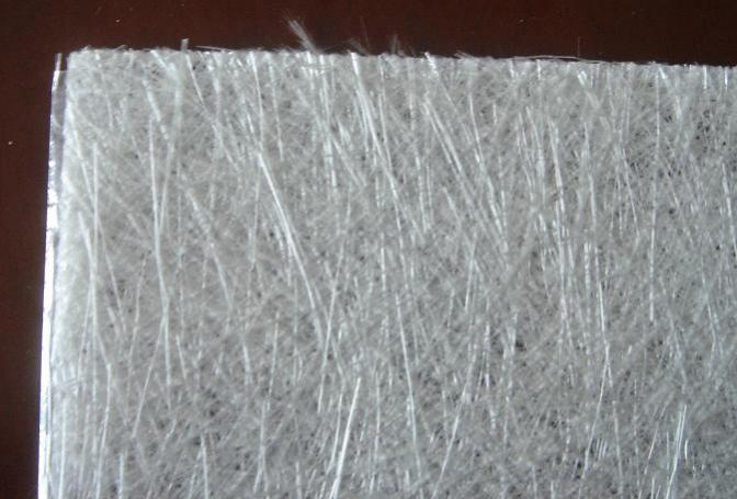

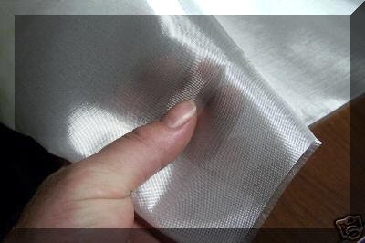

That is not true, cloth is for cosmetic purposes only, matting is for structural strength. That is a lot of peoples misunderstandings, cloth provides no structural strength whatsoever. Fiberglas Matting is what you need.
This is what it looks like.

This is what you do not want to use. This is the cloth, you don't want to repair a crack with it. It is for cosmetic purposes only.

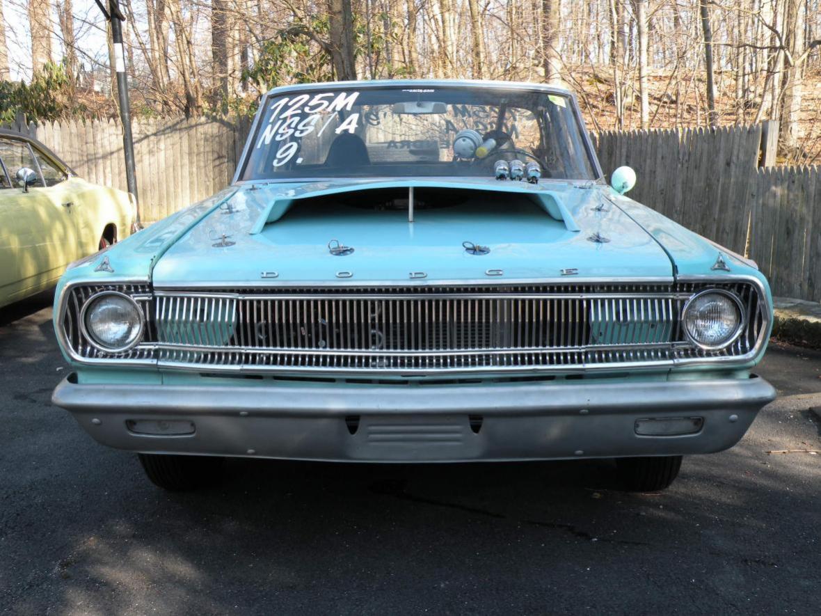

duroglass is the bomb. my 65 dodge hood has it and works the best and not messy.

Nice looking car SSR I did a hood like that once not quite that tall. Using the fiberglass you can blend that scoop into the hood and you would swear its part of the hood, maybe you do not like that type of look but i myself thought it was better then the spaces. Its all ones idea of what we like as our ride, which im not going to say to anyone it should be this or should not be. It is a nice looking car. Ron
